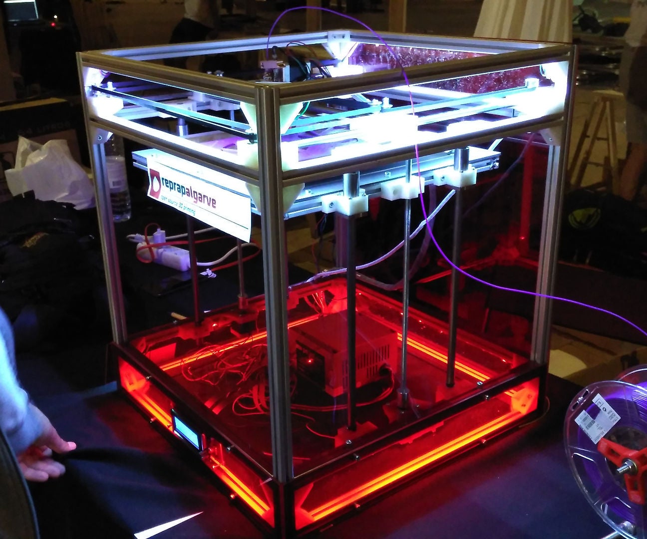

It’s pretty good, a significant improvement on the original design. My favorite design has to be: https://imgur.com/a/sPLMj#6O9Pfo4
Such simplicity and attention to detail.
@Adam_Steinmark That’s HUGE! lol. Looks like it’s powered by Niagara Falls!
Yeah but it’s scale-able. I just love how rigid the construction is, this thing could run for months without needing much maintenance.
Damn! I wish I had a work shop!
