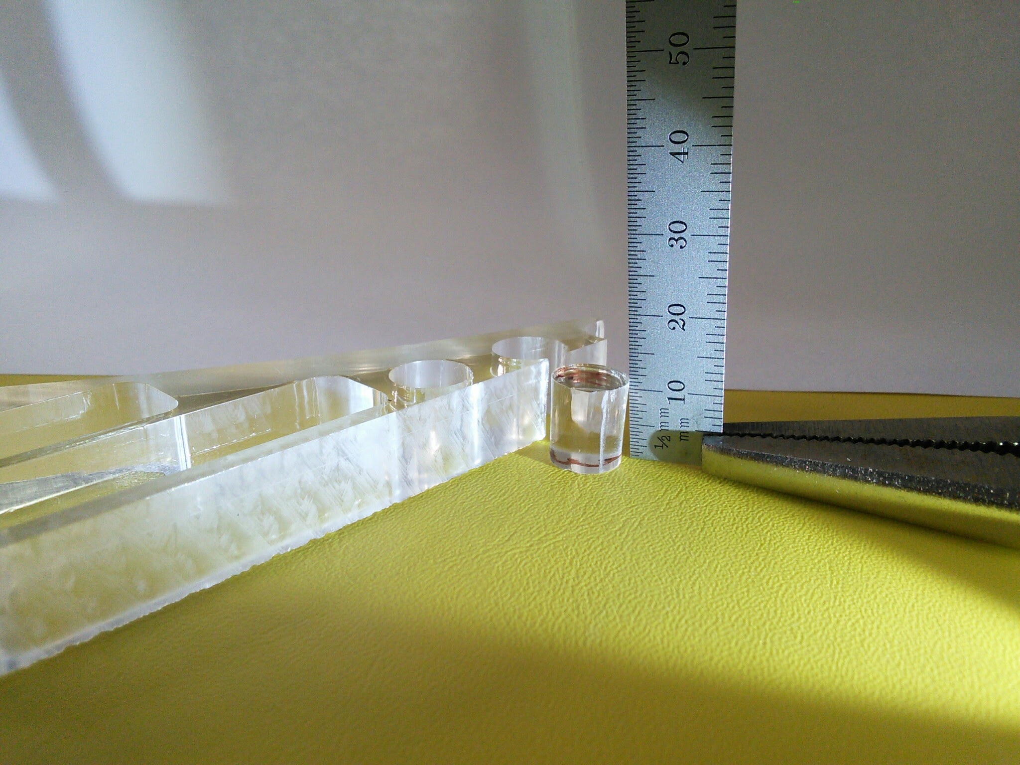

Thanks @Nate_Caine ​ thanks for the info. I’m curious about how deep can you cut on a single pass for acrylic, MDF and ply
@Ariel_Yahni_UniKpty For Acrylic, very reliably to at least 13mm (0.5"). Acrylic is a pure substance, so predictable. Use “cast” Acrylic (as opposed to “extruded”) when possible. The picture was with the 100W machine. Similar results for the 80W. Both machines with clean optics and recently aligned.
MDF is more unpredictable, because the composition varies based on the wood chips, sawdust, and glue used. Perhaps 8mm?
Do some test cuts on scrap. We had one guy do a project, and made some test cuts, but substituted his “good” MDF for the final cut. It failed to cut thru at even 6mm.
Same advice applies to plywood, which additionally might have voids and defects hidden on the inner layers. Throw in moisture content and growth patterns makes it even more unpredictable.
