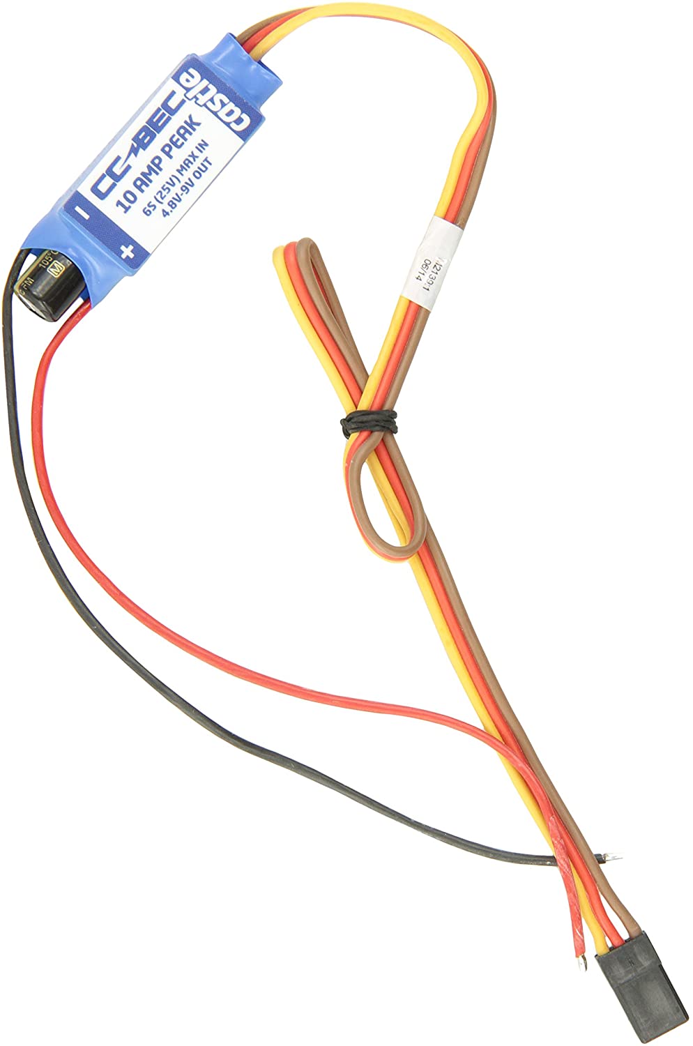

That’s the converter I’m using: https://www.amazon.com/gp/product/B00J3MHTYG

Before I used a BEC from my RC planes
Allegedly it supports 10A too, but
- it’s designed for having airflow in a moving RC aircraft
- it’s not actually meant to run at 10A continuous
It did get uncomfortably hot at 10A and I did not care to find out how long it could maintain that draw
To be fair my shirt only uses 2-3A at most because if I make it brighter (and draw more current), it also blinds people
but I figured I could use a bit more space and a bigger step down converter, so I got a bigger one that can dissipate the heat better.
The only problem with it is that when it uses 10A on the 5V side, it uses way more amps than it should on the other side, but if you stay below 10A (even 9.5A is ok), it does fine and seems efficient enough.
