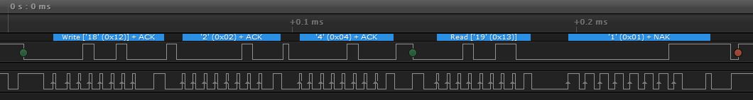

A few facts that might be interesting: 1) you can only drive the bus as fast as the slowest device connected. If you go faster than the slowest device, it will get confused, resulting in hogged sda and even scl if you’re unlucky. 2) be very careful with toggling sda. Sounds straightforward but isn’t. For instance when you need to generate a stop condition, the sda may be low or high at that point (depending on previous data). Don’t just set it low, it will be seen as a start condition. Insert a complete scl-sda cycle instead. 3) don’t pull sda one instruction after scl. At high speeds this will introduce over-speed glitches. Pull scl, wait, pull sda, wait, release scl, wait. With the proper delay you can still obtain 100 kHz operation, and up to 230 kHz (400 kHz in 160 MHz mode). If you’re going to fiddle with i2c I suggest using a logic analyzer to check all timings. Inc is not critical for clock speed, it can vary between every bit, but at no time it can be above the max speed of the slowest device.

Looks like you’re already using an analyzer, familiar one! The clock duty “should” be 50% BTW to be sure you don’t have overspeed glitches.
@Erik_Slagter Funny you say that - ONE of my devices (i2c port expander) seems not to be working now - all the rest are working fine… could be unrelated…
