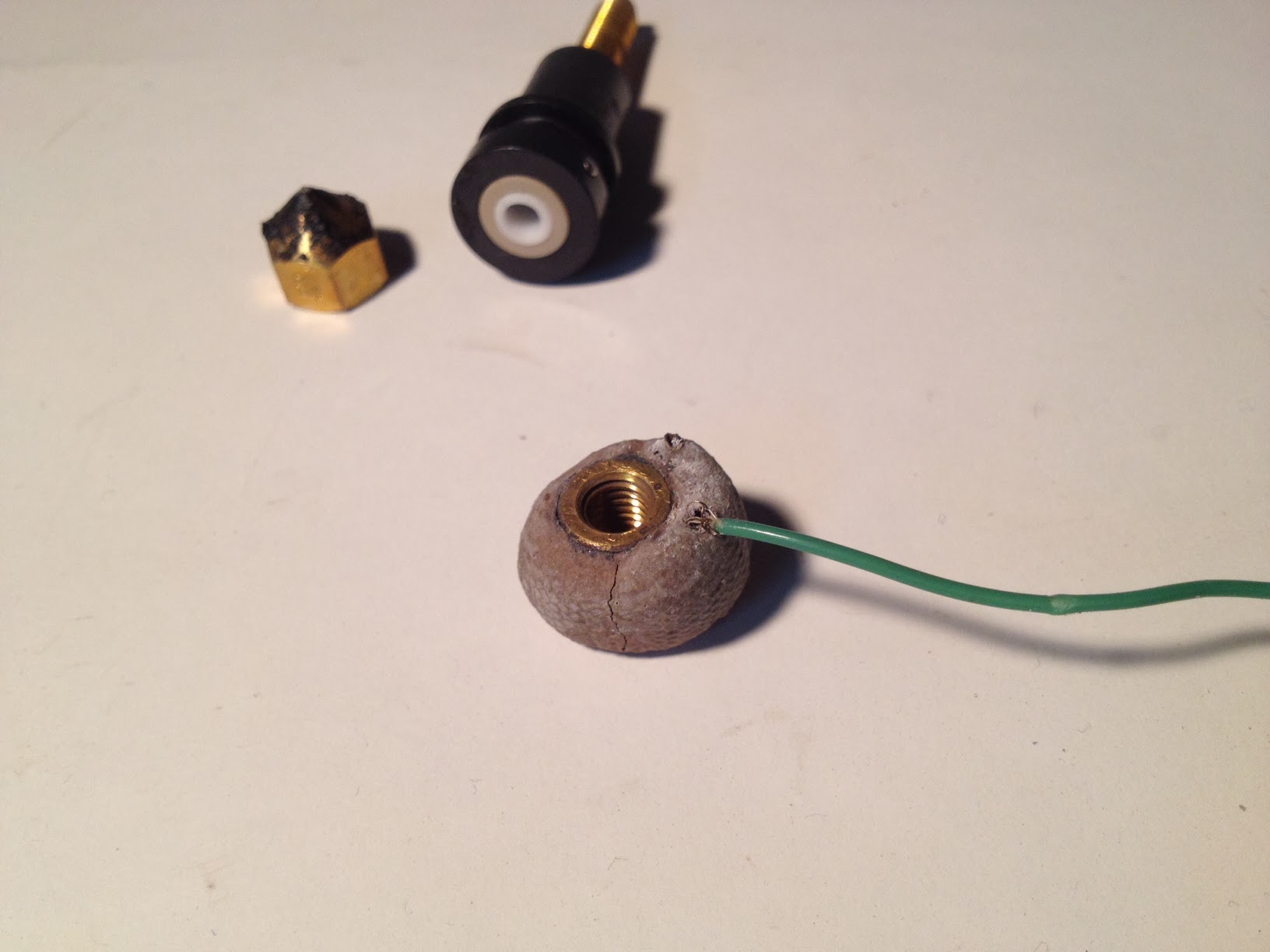

Looking for some advice... This is my old MakerGear hotend.
Looking for some advice… This is my old MakerGear hotend. You might notice there is only one wire attached, well, the other one broke off, and it’s not getting reattached.
So, what should I get for a replacement?
The “MG Plus Heater Block Assembly” from RP1 Labs looks like a simple option, but what else should I consider?

Pete Prodoehl, everybody swears by E3Ds these days (I am waiting for mine!), but another functional extruder will not hurt. There are modern variants of your heater block sold, with heater unit and thermistor, and screwable in place of your faulty one. Easy to make as well, you need a piece of aluminum, three drills and tap (M6 I’d guess). Heater and thermistor, of course…

Check the size of the main threaded part of your extruder - the one this block should wind on. If it will fit on the 6.5 mm dia. / 1.5 mm bore hole of that block it’s perfect. Or like I said, drill 3 holes in a piece of aluminum - that will leave you purchasing just a heater cartridge and thermistor. These guys on Ebay ask a lot of money for this piece of aluminum with 3 holes in it :slight_smile:
It’s absolutely repairable. Just take the ceramics off with pliers, solder the new wire and either apply a new layer of ceramics (or any other heat-resistant material and wrap with kapton).

I dug some of the wire out and used an extra crimp and crimped that dug out wire to the green. A bit of the ceramic that hadn’t cured in the container got glopped on. It’s more fragile than it was before, but i am printing again with no problems.

Hah! We just had that same problem. Worked great for years. You can rebuild the heater if you want. I’d consider checking out the newer makergear heat block. You can swap out the heater on there for one. It uses a cartridge heater and the strain relief is significantly better.
I’ve ordered the RP One Labs parts from ebay, figuring it will get me up and running quickly, at a low cost. The E3D looks very nice, but it’s about 4 times the price and right now I don’t care to spend that.
