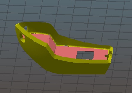

Looking for some help. I am trying to create a multi-colored Benchy print using the 3DBenchy_Multi-part_Single_-*.stl files and Slic3r Prusa edition. The hull will not will not slice correctly. I’m not sure if I am missing something in Slic3r or if the file is the issue. I opened in in Mesh Mixer, and Cura, they both looked ok, and Cura would slice the hull correctly. Any chance any of you could try and see if you can get it to slice? All the other parts seem to be good, it’s just the hull. The images have the hull and the deck only as the example. The image on the left is the 3d image tab, on the right is the preview and the output I get.

@Matt_Barth wow dude, the hull shows 379407 errors, youre gonna have ti repair that first before youll be able to print it. all the other pieces show no errors

@Cristian_Martinez yea, I did see all those errors, my repairing skills aren’t that good, I tried, and failed several times.
