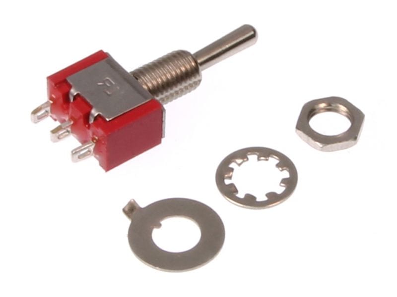

Not sure how you want achieve 3 different settings with only one pushbutton in the encoder. Maybe you want to add a ON-OFF-ON momentary toggle switch (an old window-lift switch will do):

Okay, but I want a light that i can change in color and brightness. So I have now a rotary encoder with built-in switch (click) in which in passive state it will affect brightness, active state changing color. I think its not that kind of difficult but cant get it to work myself. Thats why Im asking someone.
