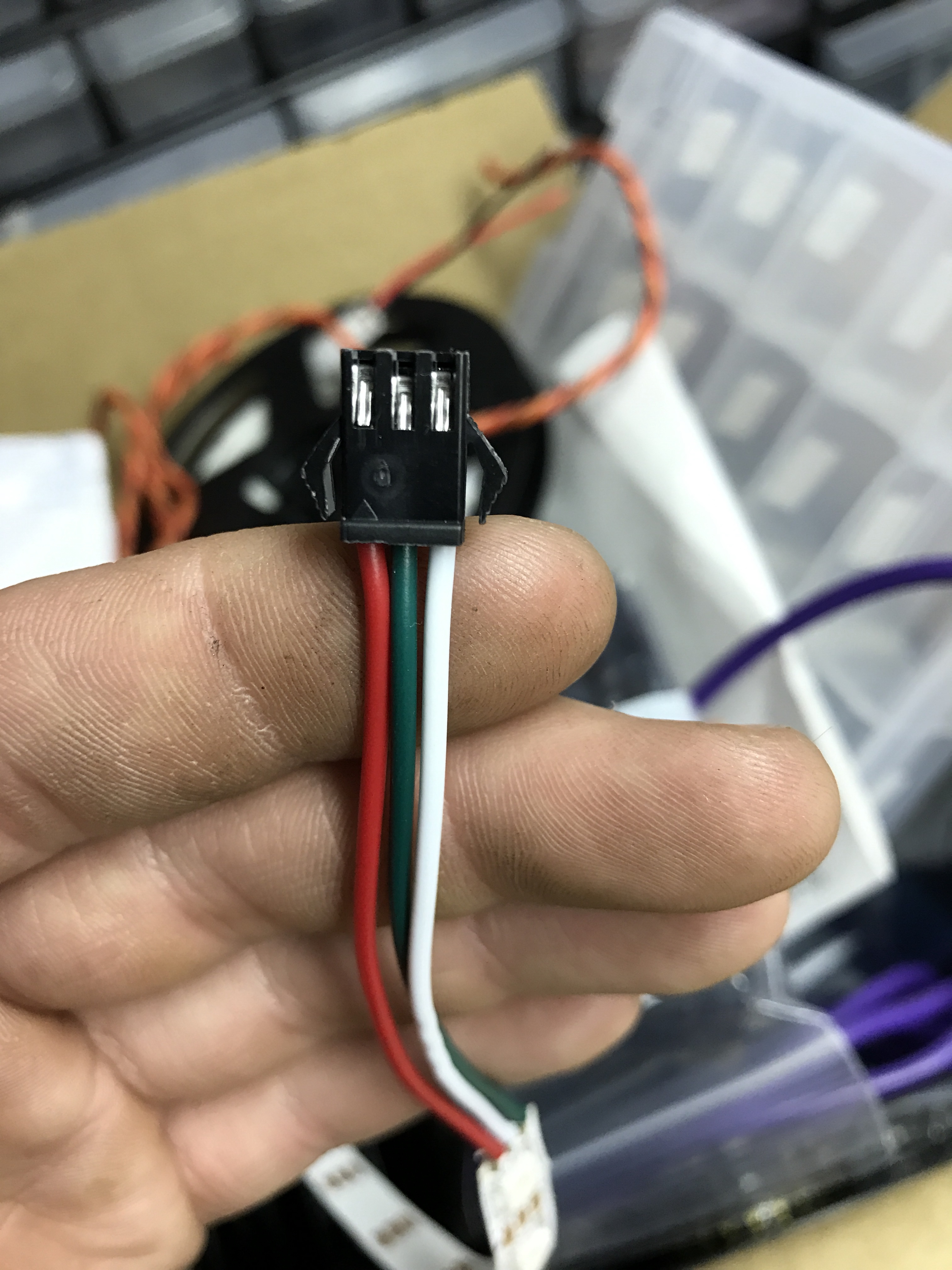

Looking for these connectors, I need male and female, 3 and 4 pin.
Looking for these connectors, I need male and female, 3 and 4 pin. What are they called and where can I find them? Preferably uncrimped pins would be nice so I can crimp them myself and not have to solder and use heat shrink. Links to a website are greatly appreciated, Thanks in advance.
I believe what you’re after is 3 and 4 pin JST SM plugs and receptacles.

eBay or Aliexpress just search for… 3 and 4 pin JST SM
exactly what Marc suggested

I get them from AliExpress, they’re 2.54mm JST connectors. This is the most common size but other sizes are available. The Japanese crimping tools are the best, but normally only available from Japan!

i just bought a hundred jst sm connectors from aliexpress, i haven’t found out which tool to buy though
they have not arrived so far though : https://de.aliexpress.com/item/100sets-lot-connectors-SM-SM-3Pin-Pitch-2-54MM-Female-and-Male-Housing-terminals-SM/32299199434.html?spm=2114.13010608.0.0.rhj3y8
Japan Solderless Terminal, in case you were wondering :slight_smile:
