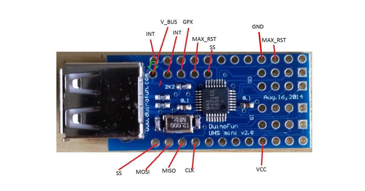

Thanks, me too and best of all some smaller boards too. Like this one which might also be found on amazon for $12 but I could not see the chip ID - Mini USB Host Shield 2.0 ADK MAX3421 SLR development MAX3421EEHJ module|Integrated Circuits| - AliExpress

I have step one working, that is wiring a USB micro Host board to a TeensyLC and getting the PS3 working over Bluetooth dongle wireless.
Teensy LC: Teensy® LC
ideapro USB Bluetooth Adapter, 4.0 Dongle: https://www.amazon.com/dp/B00OH09OXS
HiLetgo 2.0 ADK Mini USB Host Shield : https://www.amazon.com/dp/B01EWW9R1E
Wired:
Wiring:
Nano/Pro_Micro/TeensyLC         Signal          USB Mini Host shield
D10 / 10 /      10              SS              5
D11 / 16 /      11              MOSI            6
D12 / 14 /      12              MISO            7
D13 / 15 /      13              SCK             8
D2  / 2 /       2               INT             2
5V  / VCC /     5V              V_BUS           1
3.3V/ ?? /      3V              VCC             9
GND / GND /     GND             GND             3
RST / RST /     3V              MAX_RST         4
