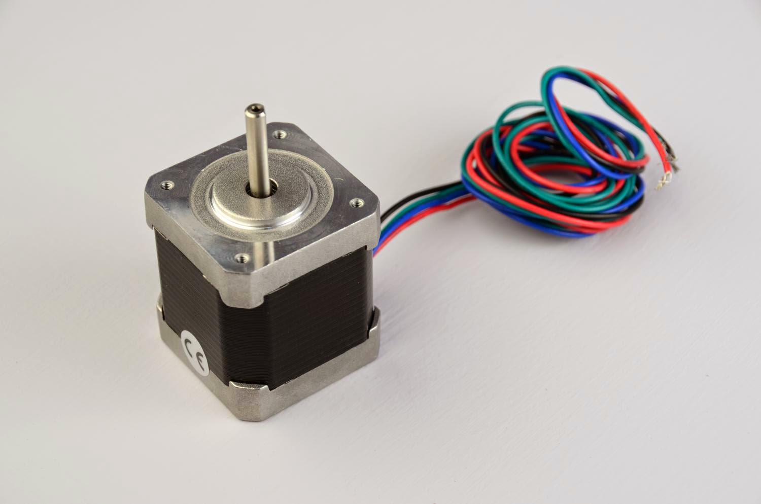

Looking to buy some stepper motors for my new build wasn’t sure if anyone had any suggestions. The controller I’m looking to buy is the Azteeg X3 with the SD8825 stepper drivers. Also I already have the motor that came with my Bulldog XL extruder so only looking for the x,y,z motors
I’ve seen some good deals for 4-5 packs of slightly used steppers on e-bay(US) but not sure their right for printers.

Careful…your stepper drivers are capable of 1/32 stepping and the motor is 0.9degrees per step. Why? Based on comments on the google delta group, you will not be able to use that high a resolution because of other limitations. You want the parts to work together as a whole to, as you say, build a printer that will have very little problems.
This combination will probably provide problems.
@Richard_Turnock O really I didnt know that with those kind of stepper drivers what deg per step would work best or how do you figure this out

for XYZ motors the key variable is the torque. You want the 5.5 kg-cm with 1.8degrees per step. then remove a jumper for your SD8825 stepper drivers and change them to 1/16 stepping. Later when you have your printer up and working, then add the jumper back in and test using 1/32 stepping. You will need to change values in configuration.h to match your stepping.

If you’re running DRV8825’s with 5% 0.9 motors you’ll be just fine. Just keep the step rate at 8x, which is near the limit of practical resolution for a 5% motor. And those phidgets steppers - 42BYGHM810’s - are not what you want - they draw more current than the DRV8825’s can provide. A better solution would be their sister motor the 42BYGHM809, which can be had from sparkfun for about $17. Here’s the comparison chart: http://www.wantmotor.com/ProductsView.asp?id=157&pid=75&sid=80

if you get the Azteeg X5 instead then you can run 0.9° steppers at 1/32 no problem

@Matt_Miller reading know thanks. I do like those 42BYGHM809’s was kind of wondering about maxing out the amps on the drivers.
