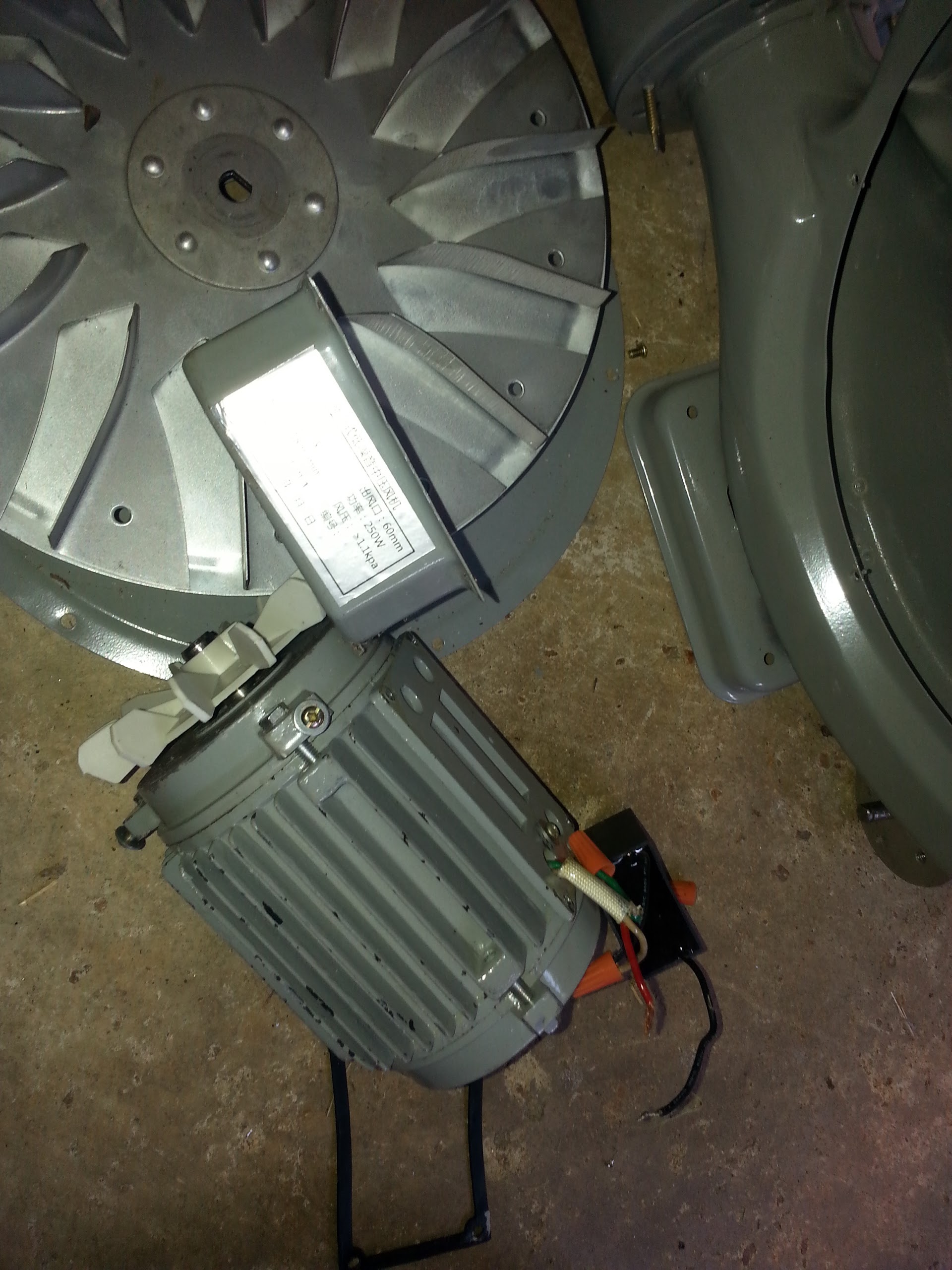

Looking to replace exhaust motor that came with the 80watt laser. Description it’s in chinese, can’t read it. This motor burn out as soon I plug in , fire spit out from back.
If you can’t find a replacement. This is what I use. I got mine a little cheaper than this but it works well and is surprisingly quiet. http://www.grizzly.com/products/1-HP-Light-Duty-Dust-Collector-Polar-Bear-Series/G1163P Inlet on mine is 4" and outlet is 5" so you need a 5-4 reducer.

thank you for the help and links.
