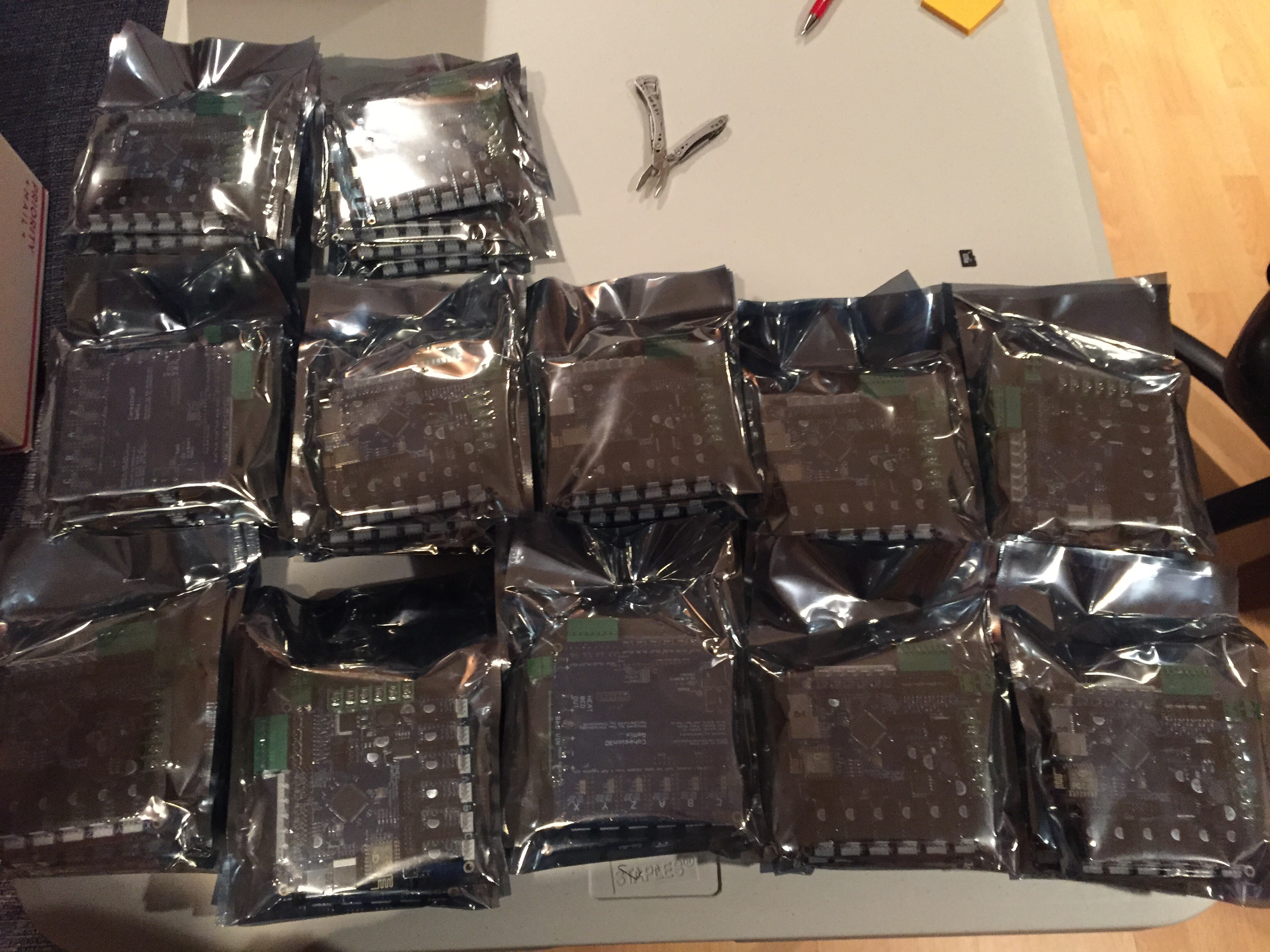

Looks like Ray Kholodovsky  is off to a great start! His new Cohesion boards
Looks like @raykholo is off to a great start! His new Cohesion boards are for CNCs, 3D printers, and Laser cutters. Did I mention they run Smoothieware? :stuck_out_tongue:

Originally shared by Ray Kholodovsky (Cohesion3D)
This is half.
