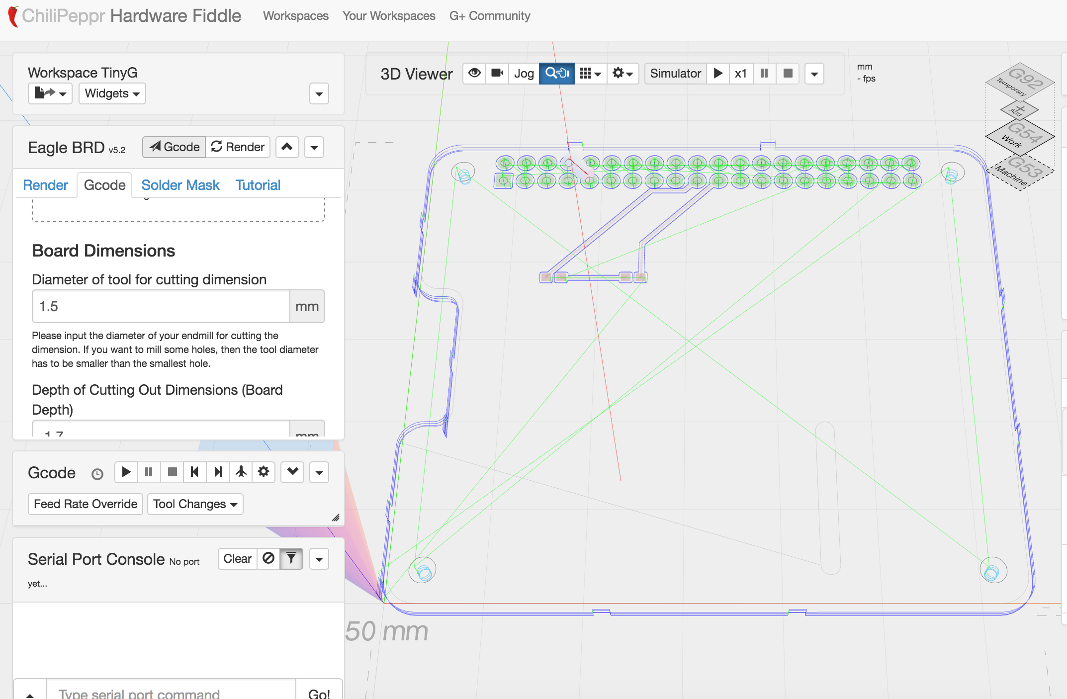

Loving Chilipeppr with my TinyG G2 powered X-Carve machine. I have been doing a lot of PCB stuff lately, specifically Raspberry Pi HATs. Per the HAT spec, I am trying to mill out a slot on the PCB for the camera connector. I am using a great eagle library that has a bunch of RPi HATs with different features, including one with the slot. I’ve used this component for PCBs from both OSHPark and Seeedstudio and all have come back with the proper slot cut. The slot is defined on the ‘outline’ layer, which I believe is correct.
I am trying to migrate my pcb milling workflow from FlatCAM (lots of steps to get toolpaths) to chilipeppr (much simpler, yay!). When loading this board into chilipeppr though, the slot does not get detected as needing to be milled. It shows up on the render, just no tool paths are created to do the milling. I made sure to chose a board dimensions cutout tool that is narrower than the slot.
Is this just too advanced of a feature for the eagle widget at this time?
