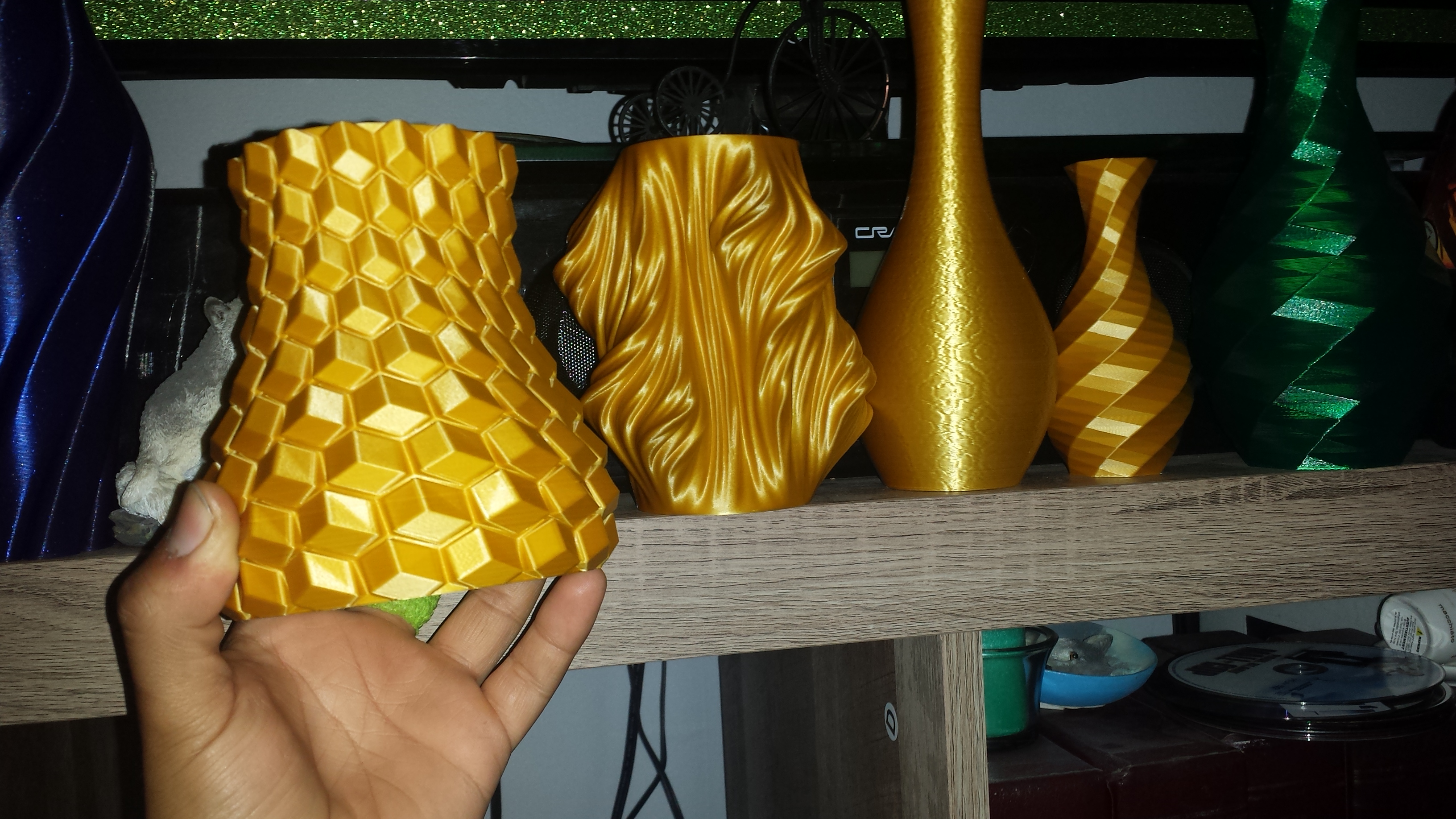

Loving this filament
Care to tell us what filament?
3D Printer Filament PLA 1.75 mm Silk Gold 1 KG ( 2.2 LBS ) Spool 3D PLA Printing Material https://www.amazon.com/dp/B06XRPYXP2/ref=cm_sw_r_cp_apap_OTbDnjFlyRQYy
That actually looks pretty sweet.
Wow looks nice for Chinese filament
Ikr. I was amazed at the quality of it
Nice finish on it!
These were all printed with a .8mm nozzle at .15mm layer height. Extrusion width is set at 1.2mm because i wanted them to be nice and thick
makes them a bit less fragile
How well does it work on more solid objects with those settings?
Ive been printing strickly vases with it. Ill print something out later and post it on here thou!
All that glitters is not gold.
No but it sure shines like it lol
ha, I knew it was gonna be that filament. Some guy posted it on the 3D printing subreddit and I picked some up as well, it’s great stuff.
