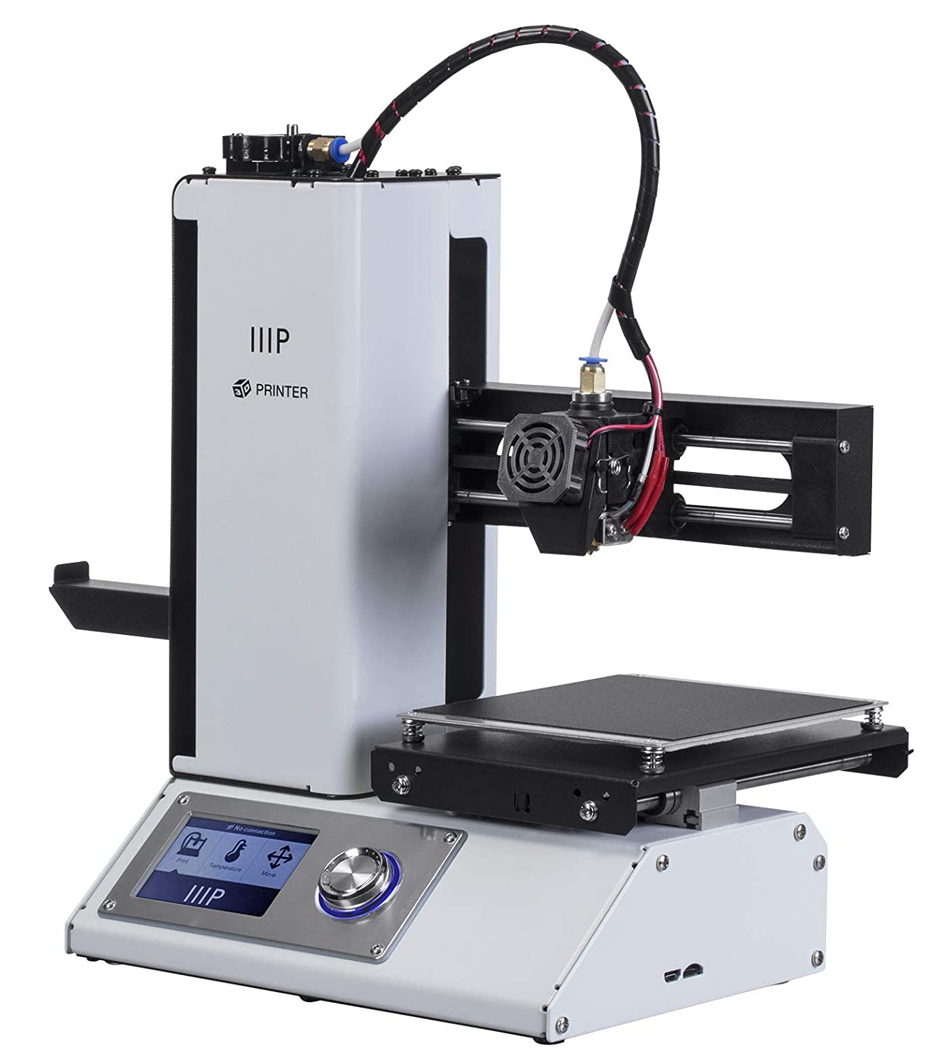

I’ll just throw out that (below) was my first 3D printer, at U$D 220 (actually I got it for $199 on sale), fully assembled.
It has a relatively small print size (120mm x 3), and doesn’t have automatic bed leveling; but has a heated bed it’s really easy to use right out of the box. I still do most of my stuff on it.
