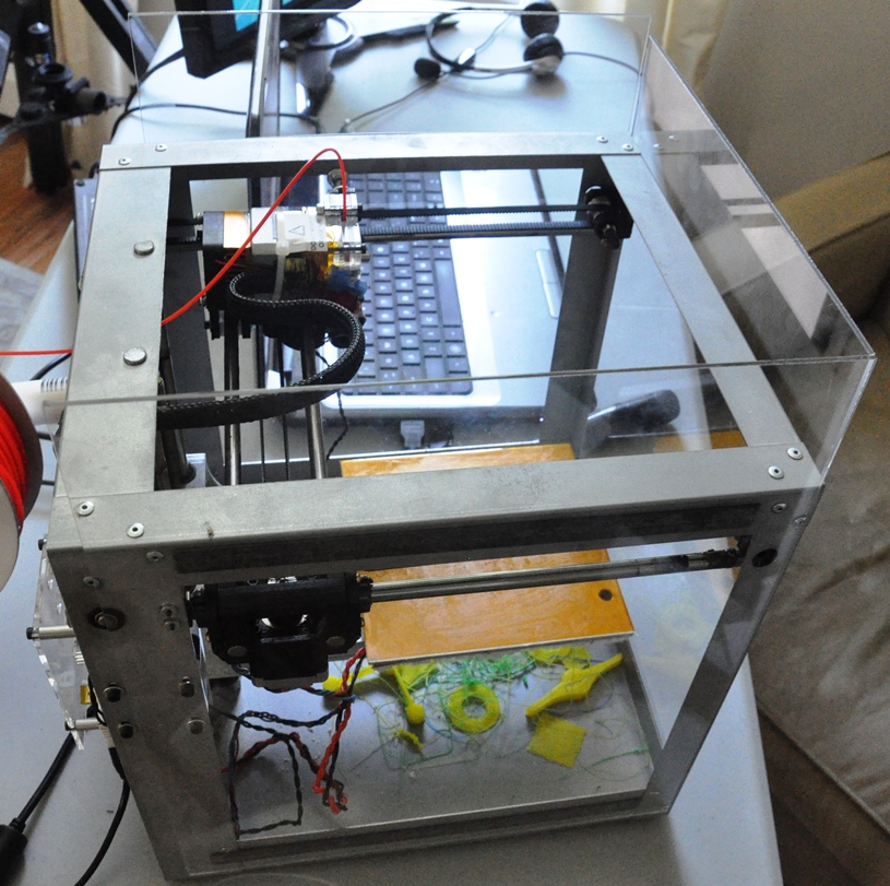

I was struggling with ABS not sticking to the platform, which I’m sure had to do with the air conditioning in the room. There is a custom solution offered by Solidoodle, but I thought I’d try a cheap solution first and it seems to have done the trick.
I bought three 11x14x0.093" acrylic sheets at Home Depot along with some magnetic tape. With the steel frame of the Solidoodle it is a convenient way to snap on and off the sides and front to fiddle with the innards and remove finished parts, while still protecting the volume from cold air currents. I can easily add a top to restrict heat loss but it is not urgent at this point. The total cost was $16.70US + tax ($4.24 each for the acrylic sheets and $3.98 for the magnetic tape).
This should work for most other cubic frame open printers - for a wood frame you’d just need to apply the tape where any stationary steel fittings protrude the sides, or just add a screw or small steel plate in a few locations and apply the tape where needed.
It’s good to see I’m not the only one who simply brushes failed prints and skirts to the bottom of the case.

This is funny because what I did was use some acrylic CD cases from a Google Chrome promotion. They have magnets and connect very nicely to the Solidoodle :slight_smile:
