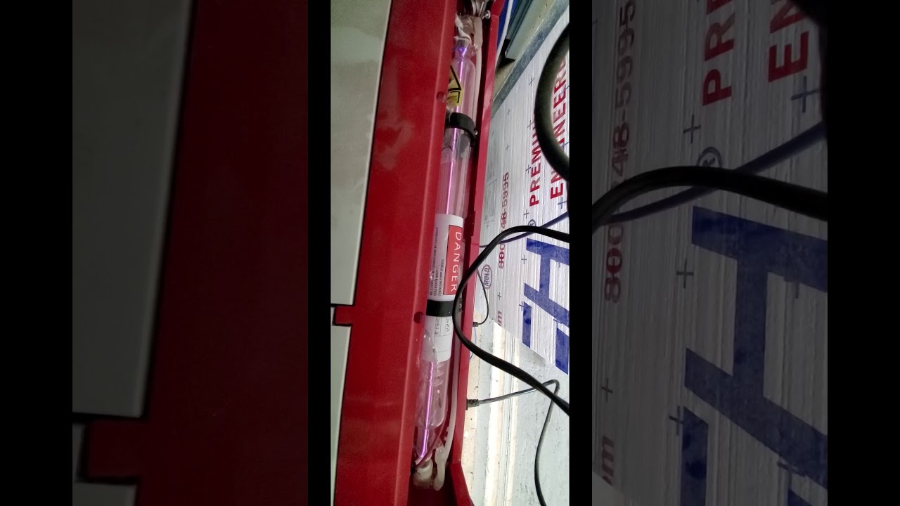

Can you post a video of the tube firing.
Do you hear any sparking,archin or crackling sounds at or after the 8ma point
I think you understand correctly. I’m not sure what counts as old for a laser tube, though. Sticker claims a manufacture date of Feb 2019. I have maybe 30 or 40 hours on it trying different things. I picked it up in January, history before that is unclear, but I think it was a return that sat in the box after the original buyer couldn’t power it on (old shipping label was still attached).
Nothing weird, just a faint hiss. Can’t even hear it on the video, I think.
