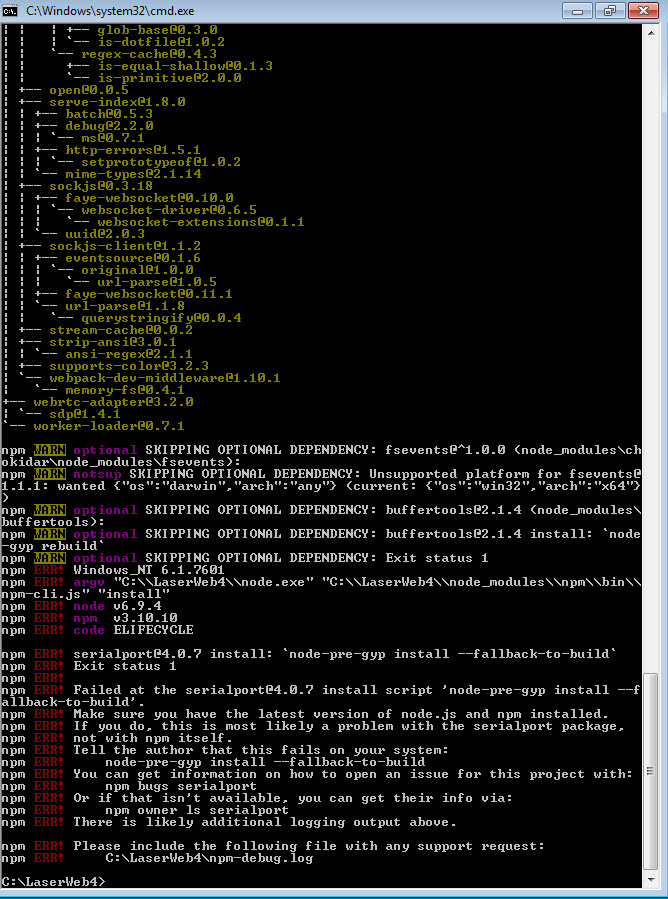

LW4 and Node installs correct but I get errors when running npm install
Any recommendation??
Node serialport needs extra help on that ancient version of Windows. Try this first: npm install --global windows-build-tools
@Cezar_Petrela you want to run it or build it. We have binaries available https://github.com/LaserWeb/LaserWeb4-Binaries
what’s the standard method to update LaserWeb4 once you’ve installed using
binaries?
@Jose_Lopez in the meantime you need to keep going back for a new binary
