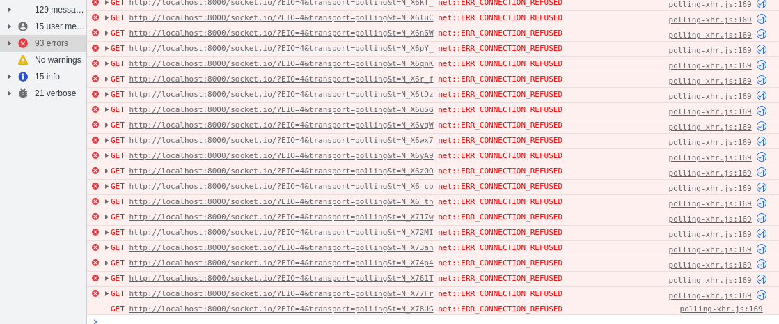

Overall it seems to work. The only odd thing I’ve found is a periodic error in the development console:
Looks like something is trying to poll and the connection is refused. Are you using some kind of custom lw.comm-server?
Note that I keep fighting with port numbers. Normally I use port 8000 for lw.comm-server and 8001 for the frontend. But with the no-cache python script or npm run start-dev I’m not sure where to change the port on the frontend, so I swapped things around with the frontend on 8000 and server on 8001. The error in the dev console could be related to that.
Edit: with npm run start-dev the frontend port is 8080
Please do not get too concerned about the console errors; the actual user experience is more important.
That said, they are important for finding errors etc, so I do look at them, and this error is an old friend…
…Your saved config is trying to connect to lw.comm-server, and failing. Clicking ‘disconnect’ in the connection box should stop it.
For most LaserWeb frontend development you dont need a working comm-server connection; it’s only really necesscary when you are testing comms or control features.
Of course, we’re in full agreement on those topics. I’m looking to make sure the whole process makes sense, from the file import to the laser turning on. I’m working on the lw.comm-server to get the code ready for a pull request and share my code on for the manual pulse generator HB04B, I was wondering if I broke something or not.
