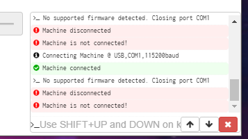

LW4 exe keeps saying no supported firmware detected when trying to connect to my
LW4 exe keeps saying no supported firmware detected when trying to connect to my Cohesion board. Any ideas?

Figured it out. LW4 does not update itself if a new device is plugged in when open. I closed the program out, plugged in the laser, and re-opened the application and it showed the correct com port. All works now.
