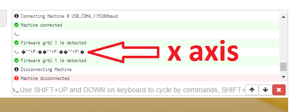

X axis can’t move then driver be come hot,
Y axis no problem,
this happen when i change the direction of motors both axis (press jog + motor turn to - )
then the character appear (picture)

Those characters not sure what they are @cprezzi ?
@Ariel_Yahni_UniKpty
I guess X axis board problem, i move the drive and stepped to Z axis connection then try jog Z axis then motor run with no more hot, also try with Y axis same driver and stepped also run smoothly
@adam_ian you board with integrated drivers Or droop in? If drop in the change drivers X to Y and try
The characters seems to be communication errors. The source can be a bad USB cable or board problem. Which board are you using?

droop in, already change X to Y no problem stepped can move.
@cprezzi
I try to change other cable, same problem. I’m using CNC shield compatible.
