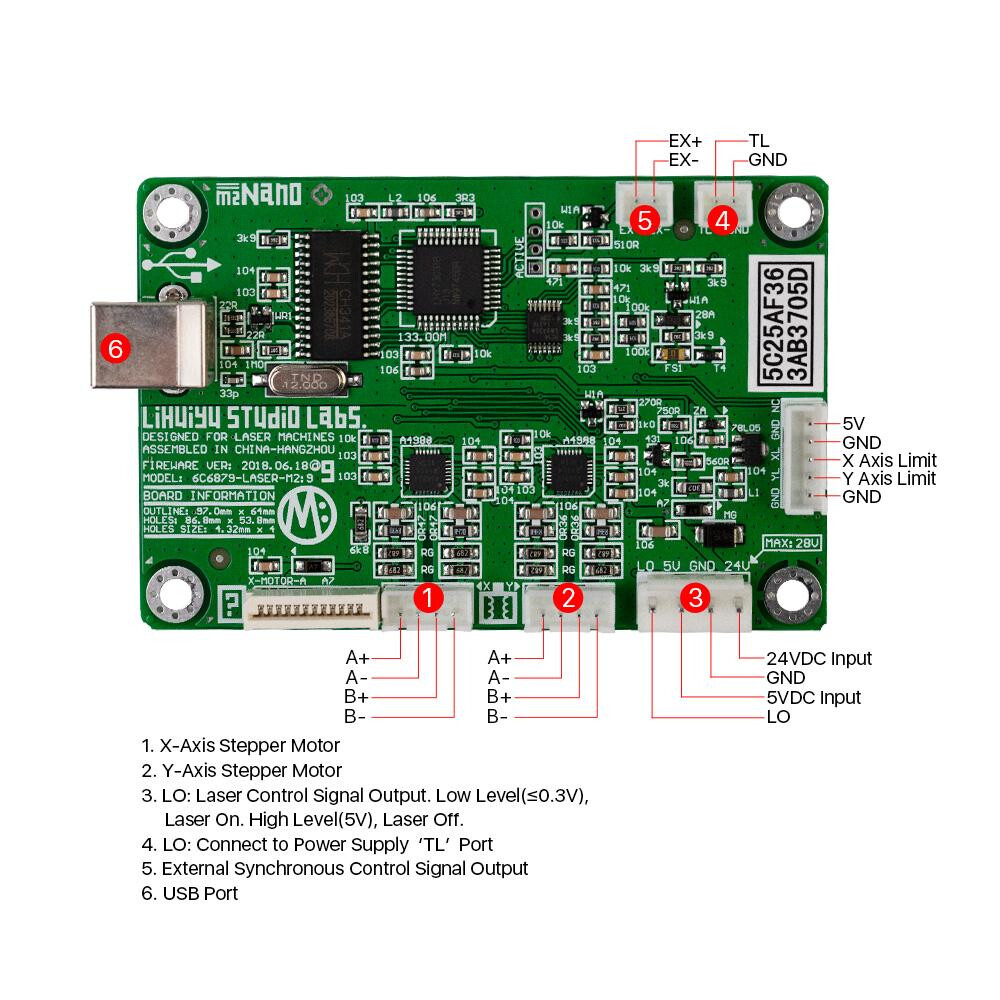

those are two quite different controllers since the M2Nano comes with stepper motor drivers and the Ruida is just the controller( you’ll also need external stepper motor drivers ).
There are probably some people who have put a Ruida in a K40 but most go with a Smoothieware or GRBL or other buffered Gcode based controllers which also have onboard stepper drivers.
Having said that, the M2Nano doesn’t have many connections to the laser cutter. Power coming into it is 24V which not only powers the board but also powers the onboard stepper motor drivers, there are the 2 stepper motor connections( 4 wires each) and then there are 2 end stops which on mine was a 3 wire connector with 1 ground wire and the other 2 wires were end stop switch signals(ie the ground went to each endstop and the other side of the end stop switches had their own wire back).
There should be plenty of M2Nano/K40 wiring diagrams in these forums. I doubt anyone has a wiring harness adapter cable since you will need some stepper motor drivers too.

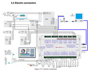

Its relatively straightforward to create yourself a final diagram by using a combination of the documents below.
If you need help or want the “TO” wiring diagram checked come back here.
If you complete a diagram please share with the forum.
The “TO”
This diagram can provide you the base for how the functions should be wired when completed i.e. the "TO:
The “From”:
This diagram should provide you what the wiring is now.
DRIVER REFERENCE
This diagram [not the same as Ruida 6445G] provides more detail on stepper drivers. If you use other than the drivers shown reference their manuals.

The rudia manual above will provide the setup instructions for the controller.
ENDSTOPS
If you use the stock optical endstops you will have to verify that the electrical interface and signal polarity is compatible.
If you have the ability/desire to mechanically mount switches instead of the stock opticals for endstops you can do that as well.
POWER SUPPLY
You will have to add a 24V external supply assuming you run steppers on 24V.

if you can read and understand schematics and wiring diagrams and know how stepper motor drivers work at the I/O level( not inner workings ) then you should be able to purchase drivers, power supplies, wire and connectors and install a Ruida controller. Otherwise, the C3D is a drop-in replacement.
