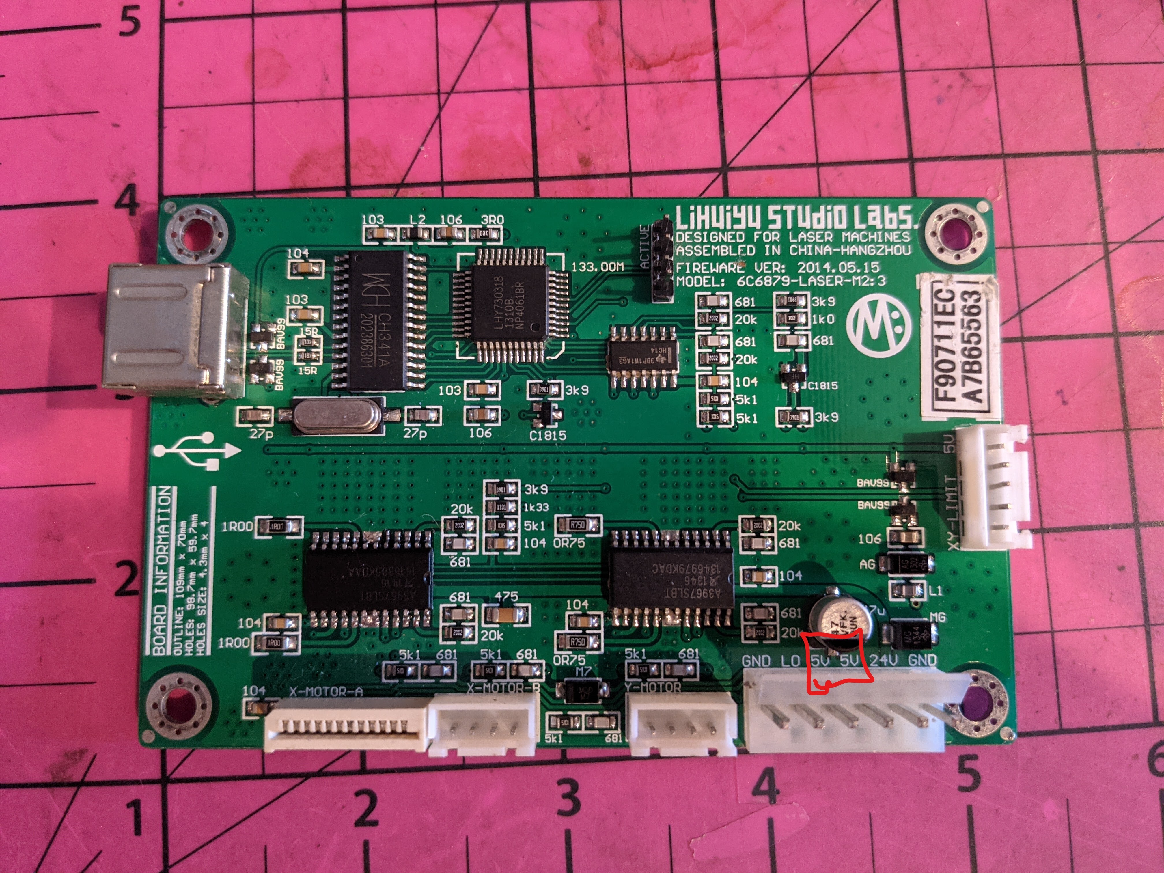

I did these checks on the three boards I have:
  • 342A-28: what connects to pin 28? i.e. provides 5vdc for the logic bus.
  • 5V- in: is there a 5v pin on the DC power connector?
  • 5V out: what provides power to 5V on the end-stop connector (right side of the board)
  • 7805: is there an internal 7805 5V regulator
  • LM317: is there an alt 5V regulator
  • USB to 5V: is there a connection between internal 5V and USB 5V?
  • USB to Gnd: is there a connection between Nano ground and USB ground?
I tabulated these measurements below:
---- **Nano 5V power schema ----
Model Firmware 341A-28 5V 5V in 5V endstop out 7805 LM317 USB to 5V USB to Gnd Note
6C6879-Laser-M2:3 2014.05.15 5V in yes 5V in N N N Y 6 pin with 2x 5V-in pins
6C6879-Laser-M2:7 2015.07.15 5V in yes 5V in N Y N Y What is 317 for?
6C6879-Laser-M2:9 2015.010.15 LM317 yes NC N Y N Y 2x 317, 5V is derived from 24V

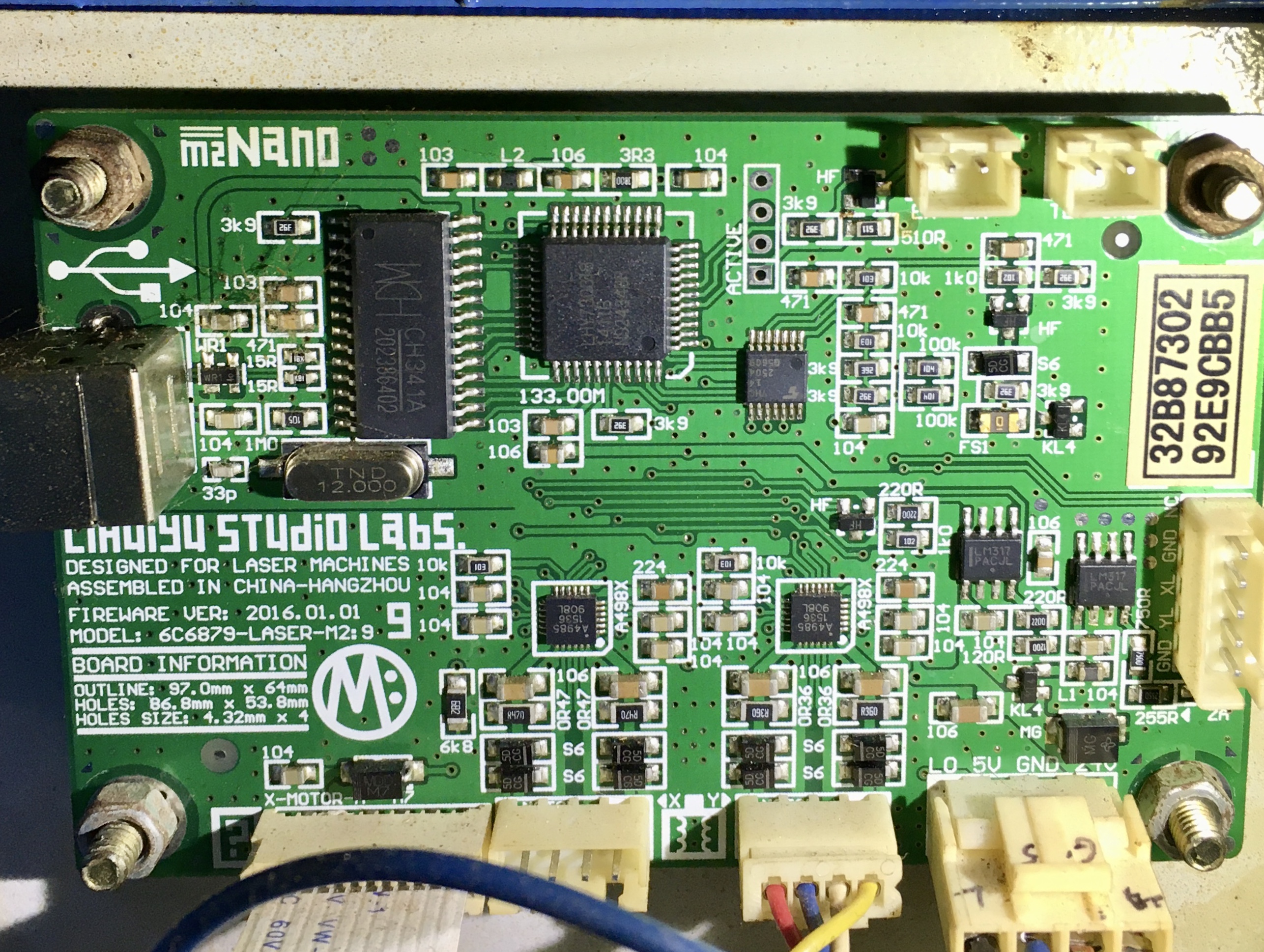

Lol. What a mess. So, there’s a green V9 from 2018, a green V9 from 2016 (DRV), and a blue V9 from 2015. And the blue and green non-DRV V9 versions aren’t even the same.
I wonder if at least the “firmware ver” date can uniquely identify them.
I thought I had the same green 2018 V9 as the one in dougl’s pic, but nope, mine’s not a 2018.06.18 V9, it’s a 2018.01.08 V9.

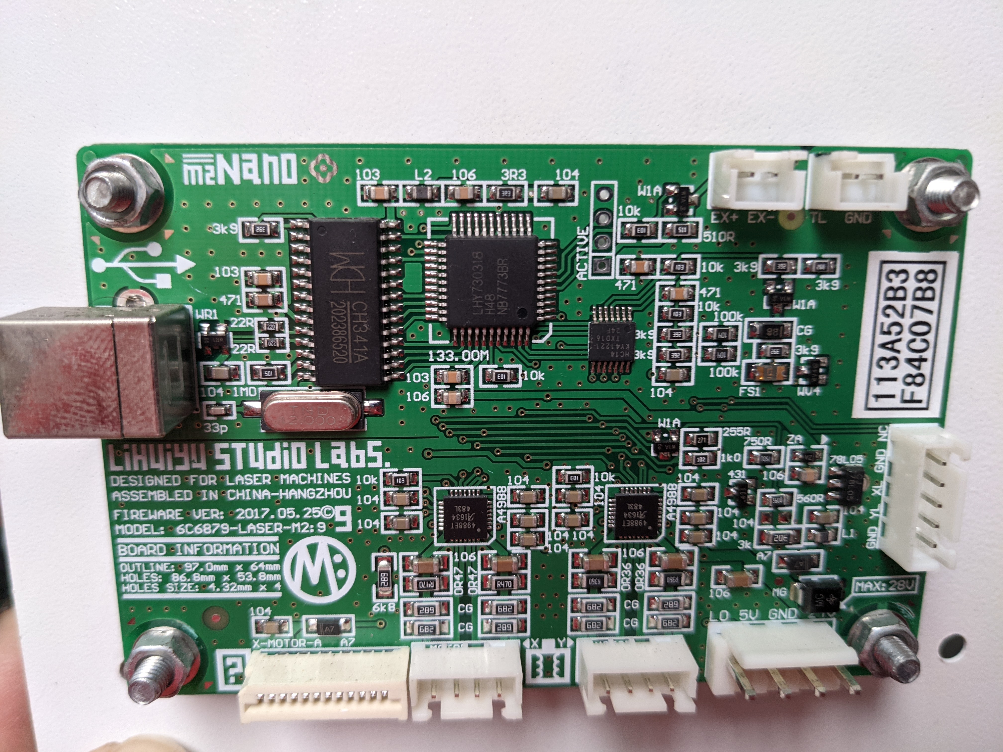

Just to add more data, my M2 Nano is a green board 6C6879-Laser-M2:9 with 2016 firmware and the layout appears to match Don’s 6C6879-Laser-M2:9 with the 2015 firmware. 5V derived from the 24V.
If yours is like mine & the 5V-in pin is not connected to anything?
Theoretically you could disconnect that 5V connection from the LPS and is would still work!?
Yea the 5v isn’t connected to anything on mine either. I’ll try disconnecting the 5V to verify.
Picture of my board
LOL … An M2:9 only with a 7805 and no 5v to the end-stops. Clearly the model # does not capture the hardware version!!!
On my board, when I powered from 24V in, I measured 4.? volts on the end stop pins so there some some thing there even if pullups through the uCPU.
