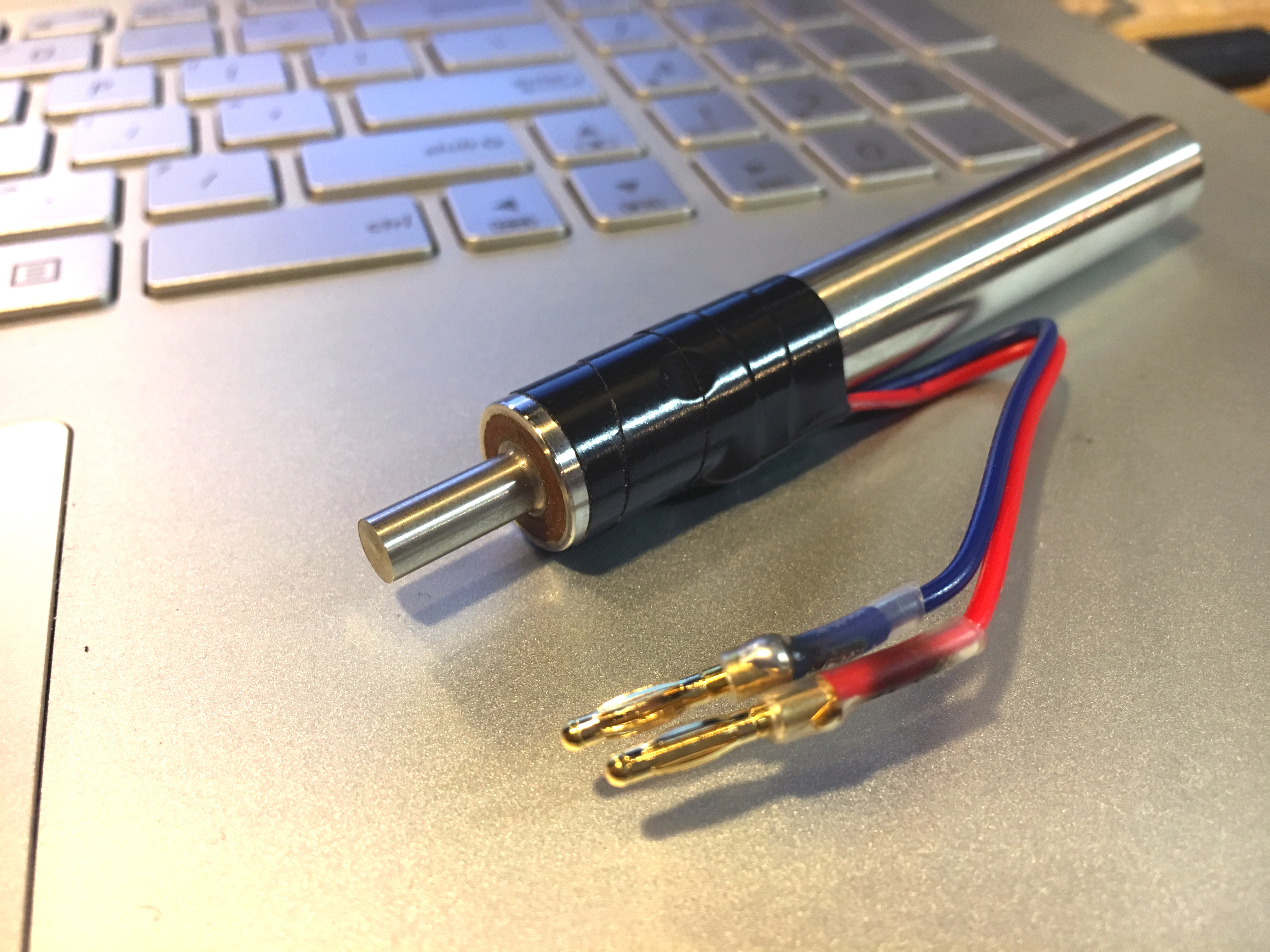

Does anyone have the scripts for X & Y edge finder? I have finally gotten around to modifying an electronic edge finder to work as an probe input.
I have looked everywhere and have only found the center finding script. Unfortunately, I don’t know enough coding to modify it from there.
Just need probing from LEFT to RIGHT, and from FRONT to BACK (positive direction)

I have one of these around. Is there any way to get these shorter (remove the battery compartment) and mountable in an ER11 collet?
I gave up and got myself one of these USOVO electronic edge-finders for 200eur instead. (way too expensive but I needed something that works.)
