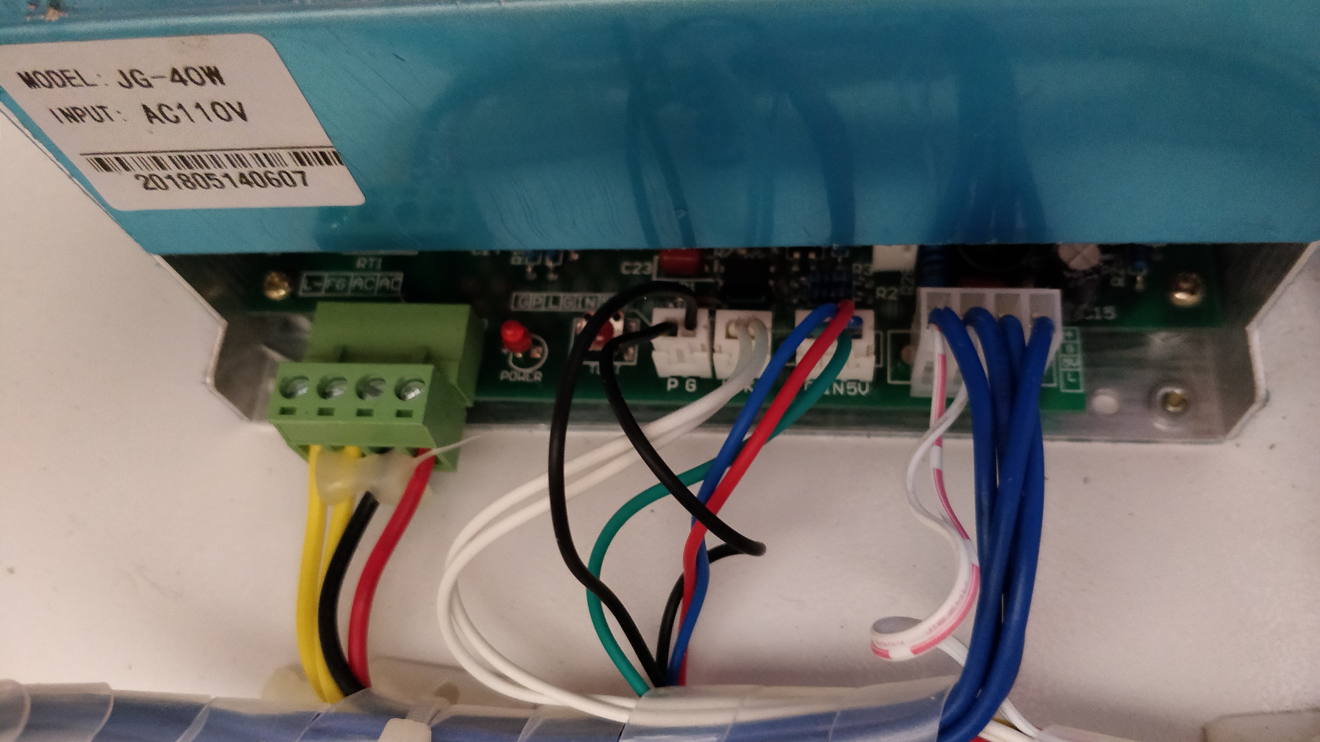

Show us a picture of the Laser Power supply showing its connectors.

I will get a picture tomorrow when i get to the lab but i haven’t moved any connection besides replacing the stock board with identical one

Here are picture of connectors in power supply and board.

DC voltages look ok. 4V on pin 4, the L pin, is ok. It gets pulled to gnd to fire the laser.

Note: in the picture on the far left connector one pin looks pushed up…

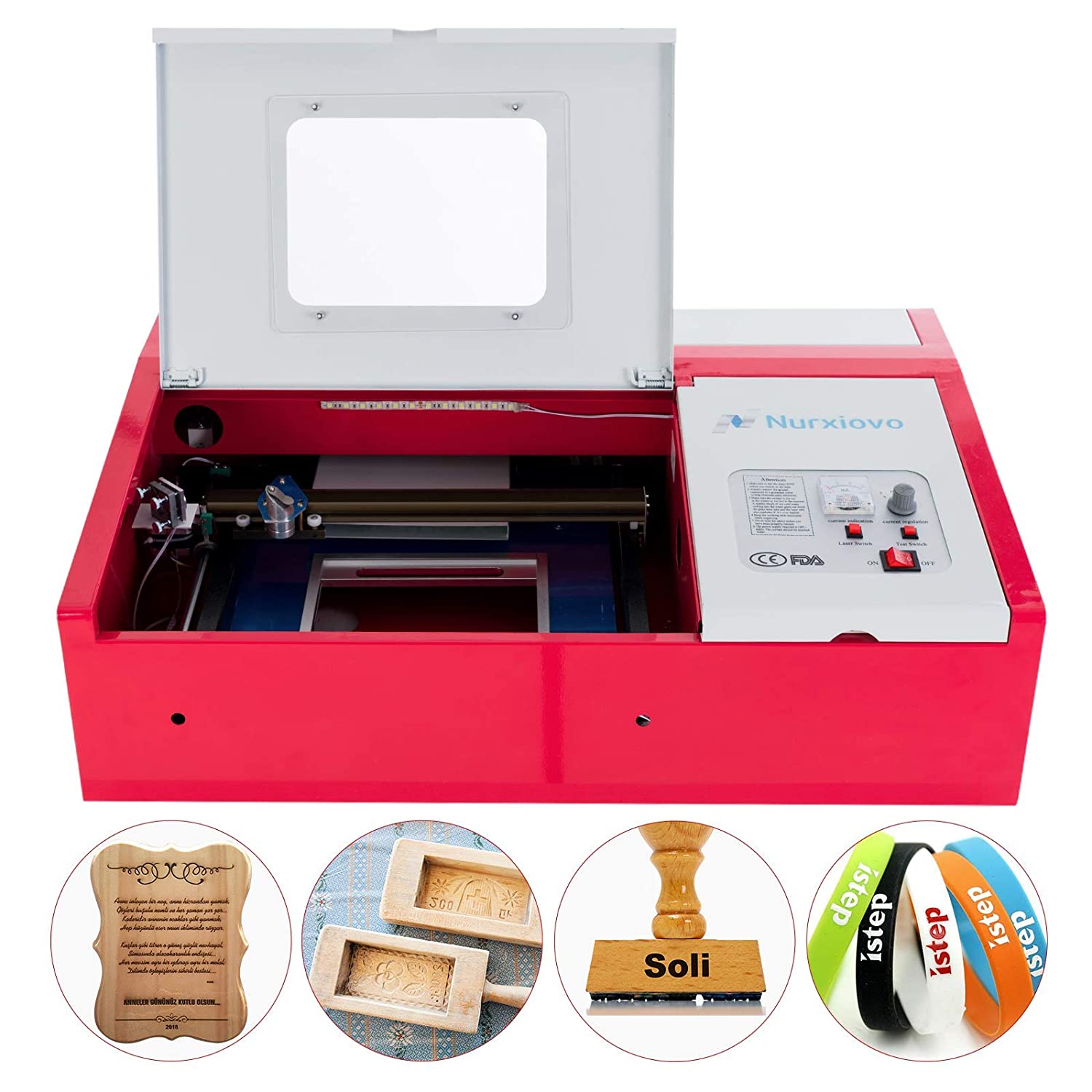

My machine is the below one

K40 Whisperer should work with your laser controller board but if your board will not work with Laser Draw I suspect it will not work with K40 Whisperer.
