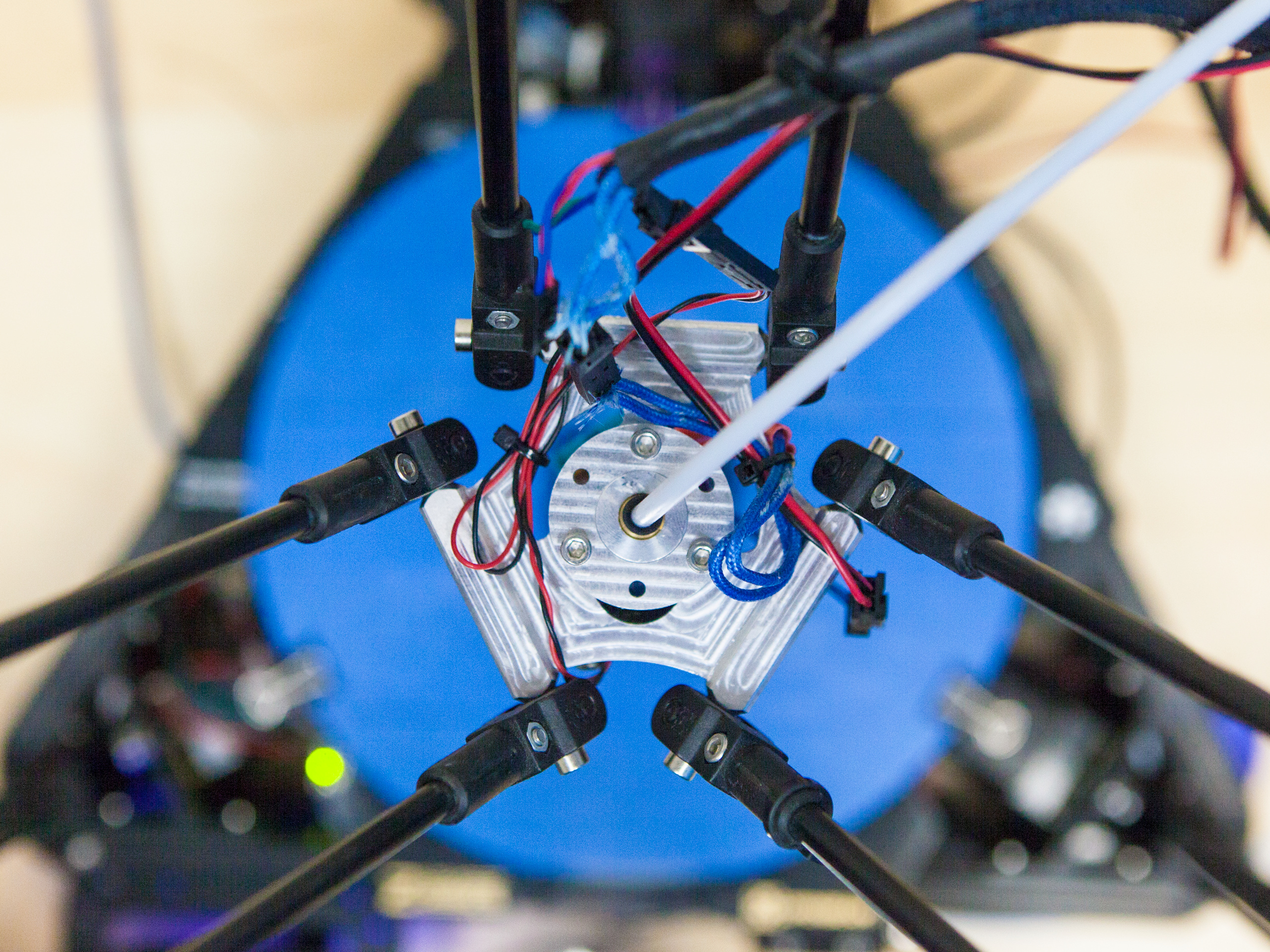

Made a CNC milled aluminium end effector for the Kossel Pro with the Carbide
Made a CNC milled aluminium end effector for the Kossel Pro with the Carbide Nomad. Holds an E3D hot end. Full write up coming soon.

Beat me to it, do notice any performance difference with the increased mass assuming it’s a noticeable difference in mass.

Interesting! What is the total weight? Would love to see more detail on how you clamped the hot end and how thick the overall effector is.
The total mass is actually slightly less than the stock end effector (106 g vs 109 g), but its more than the printed PETG end effector I was using previously. The thickest parts are 6.5 mm. Its made from a (roughly) 1/4" thick aluminium plate.
