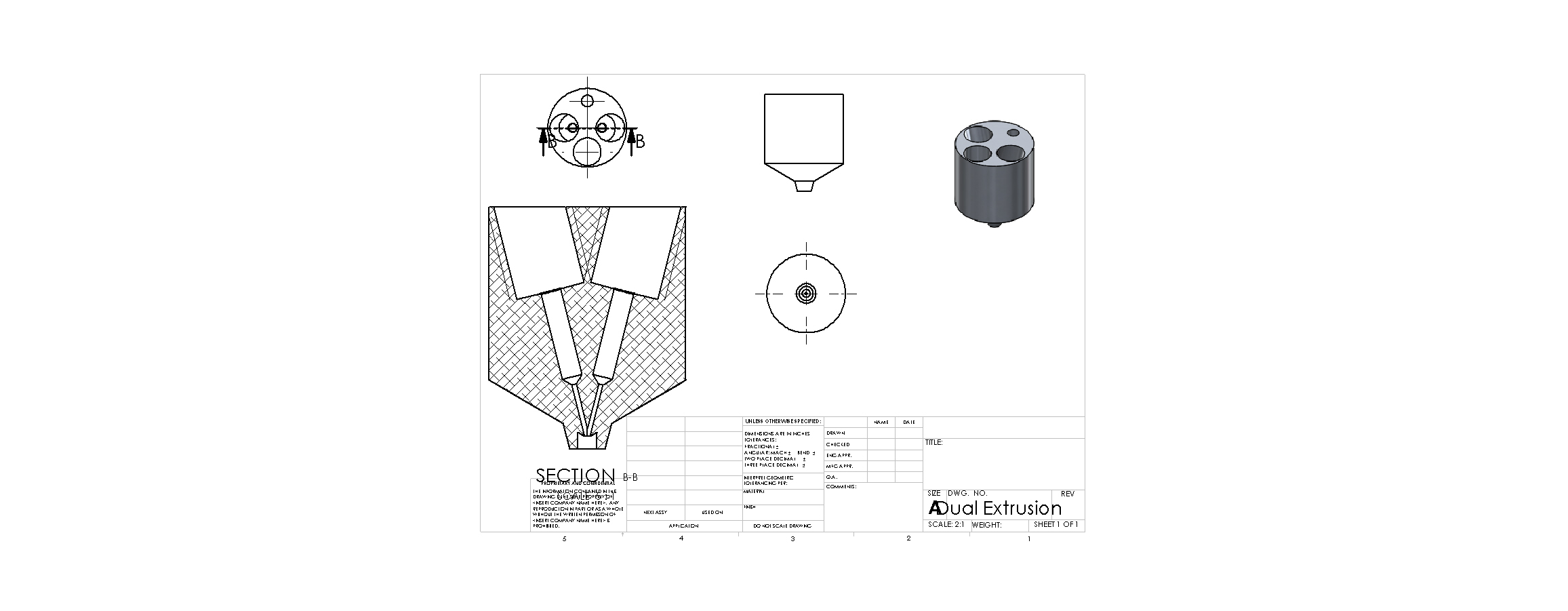

Made a drawing of my dual extrusion hotend for airbrush nozzle

Why use dual extrusion? Seems like more of a pain to use. Not to mention that you’d have to use 2 rolls of filament, wouldn’t you?

Thanks. Channels leading to the nozzle seem smaller than 1mm?

They are 0.4mm in the drawing. I had no smaller drill than 1mm when made it.
Those are quite long 0.4mm channels, seems like it would cause quite some back pressure…

It’s a principle drawing. The one I made has 1mm channels. Waiting for some parts for the extruder before I can do any tests. The goal is less lag with replaceable nozzle.
