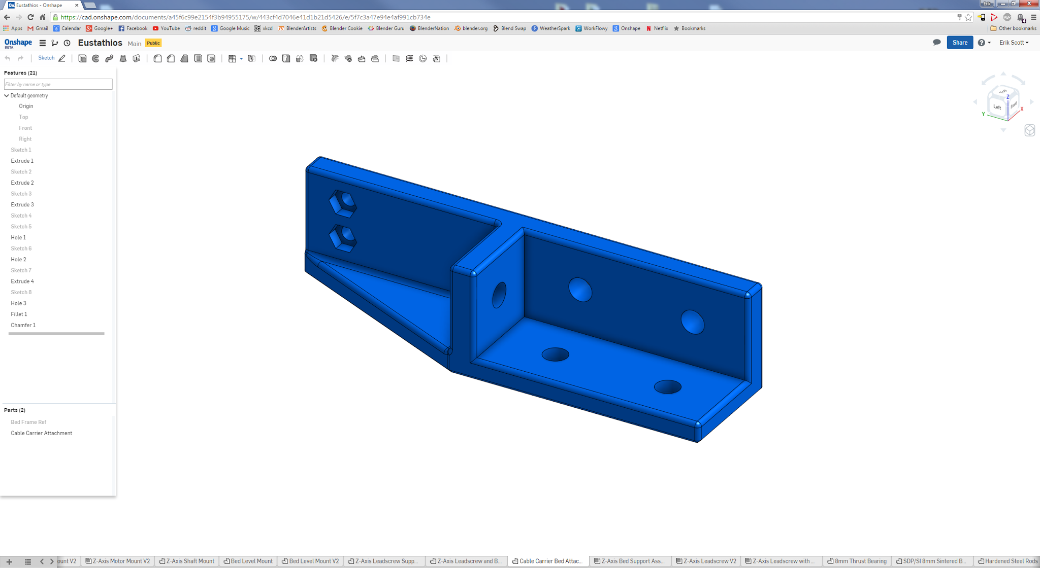

Made a quick mount for a cable chain to carry the heated bed wires. It would make the printer look nicer and cleaner, but I am a bit worried this may put some forces on the bed that may be undesirable and affect print quality. The chain will ride on the left-rear vertical extrusion. I couldn’t make this work in the CAD assembly, unfortunately, but it will in real life. Thoughts?
I might try to have it connect closer to the rods to avoid it pulling the bed out of tram.
That’s what I’m worried about, but I’d have to add something to keep the chain straight.

STL: https://www.dropbox.com/s/tv3d5lpu20gqnbp/Eustathios%20-%20Cable%20Carrier%20Bed%20Attachment.stl?dl=0
STEP: https://www.dropbox.com/s/bptsqo3d0n4fcn5/Cable%20Carrier%20Bed%20Attachment.step?dl=0
@Erik_Scott Do you have an STL file for just the bracket? Also what cable chain would I use with this?
Oops, forgot I had some reference objects in there. This should be a clean version: https://www.dropbox.com/s/ff5gt801vdbrqlt/Eustathios%20-%20Cable%20Carrier%20Attachment.stl?dl=0
