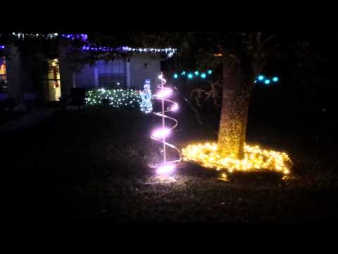

Made a spiral tree out of a 5-meter strip of APA-102 .
Made a spiral #Christmas tree out of a 5-meter strip of APA-102 #LEDs. I think it turned out pretty good for being made out of some leftover #PVC and steel wire. It’s being controlled via a ~$2.50 arduino Pro Mini clone with a 2A 5V wall wart sitting inside a cheap Ziplock plastic container.
It’s running a slightly modified version of the ColorPalette example in the #FastLED library. I’ll do some more programming once I figure out what to do with my other 5-meter strip.

There isn’t much in the way of Christmas stuff here in the Islamic Sultanate, so I showed this to the boss and she said ‘go for it!’. I’ve got an old Ikea standard lamp upright I can re-purpose and some steel wire I used to snake/monitor-proof the fence that will do the job just great. I think I will pick up some rice paper to give it some diffusion and ‘body’, though. Great idea, @Dan_McDougall

@Josh_Ward ​ Oh yes. I didn’t have time to play with it much after setting it up but I’m definitely going to try out that Holiday Twinkle code. Love the idea about making it green.
The reason why I have it mostly rainbow colors at the moment is because that’s what my 5yo daughter likes the best (and my 7yo son didn’t have an opinion hehe).
