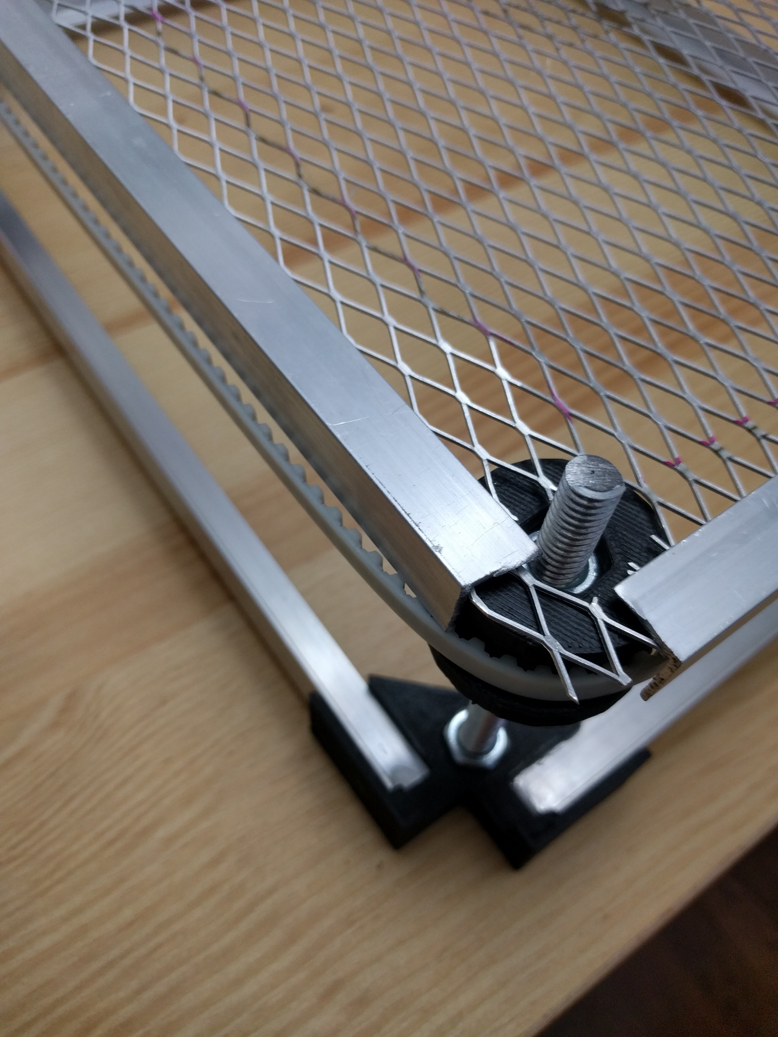

Made an adjustable bed based on: https://www.thingiverse.com/thing:1906231 Added the angle aluminum to strengthen the expanded aluminum because it was super flimsy. However now the belt skips teeth because of the extra weight. Any recommendations on how I can tighten up the belt?

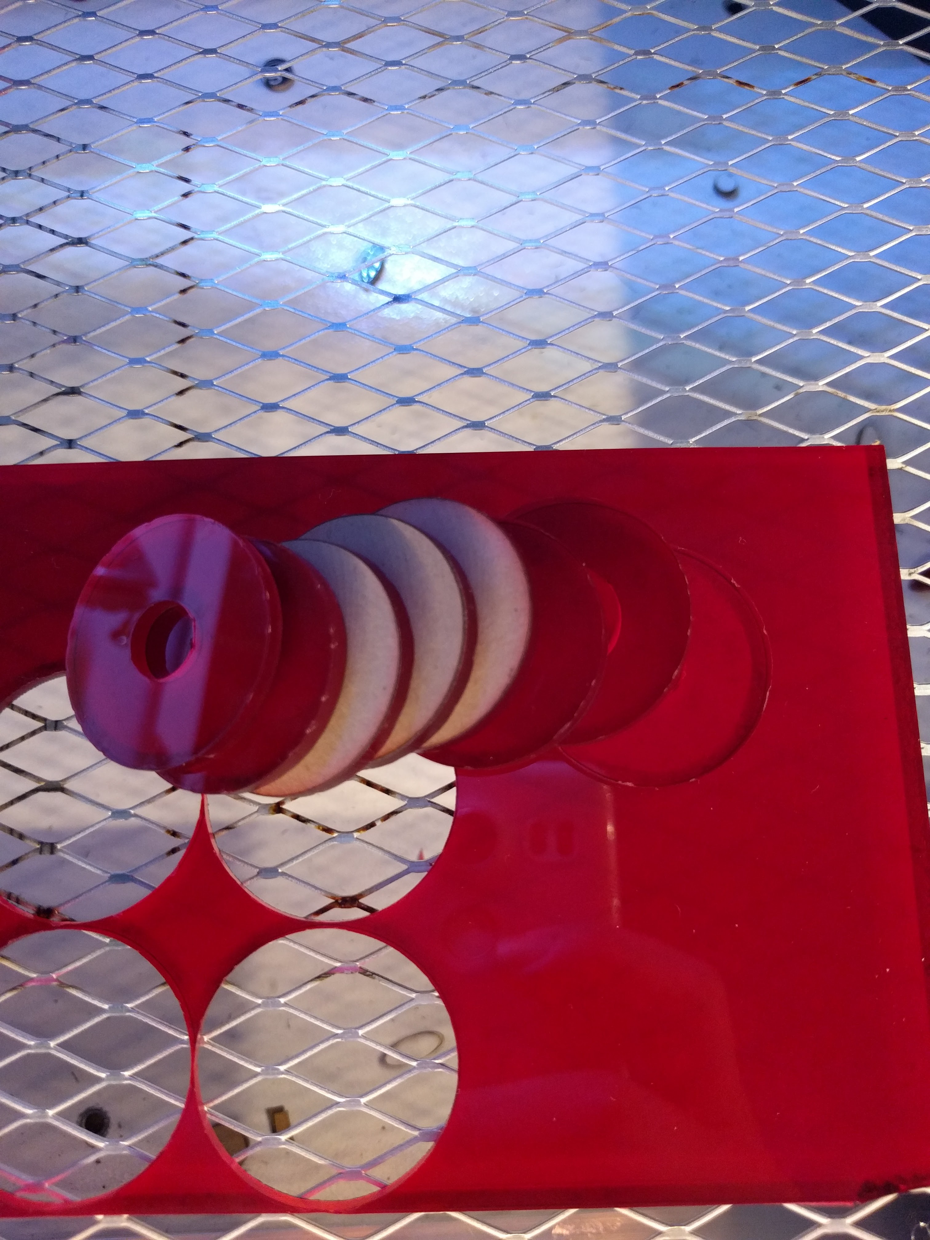

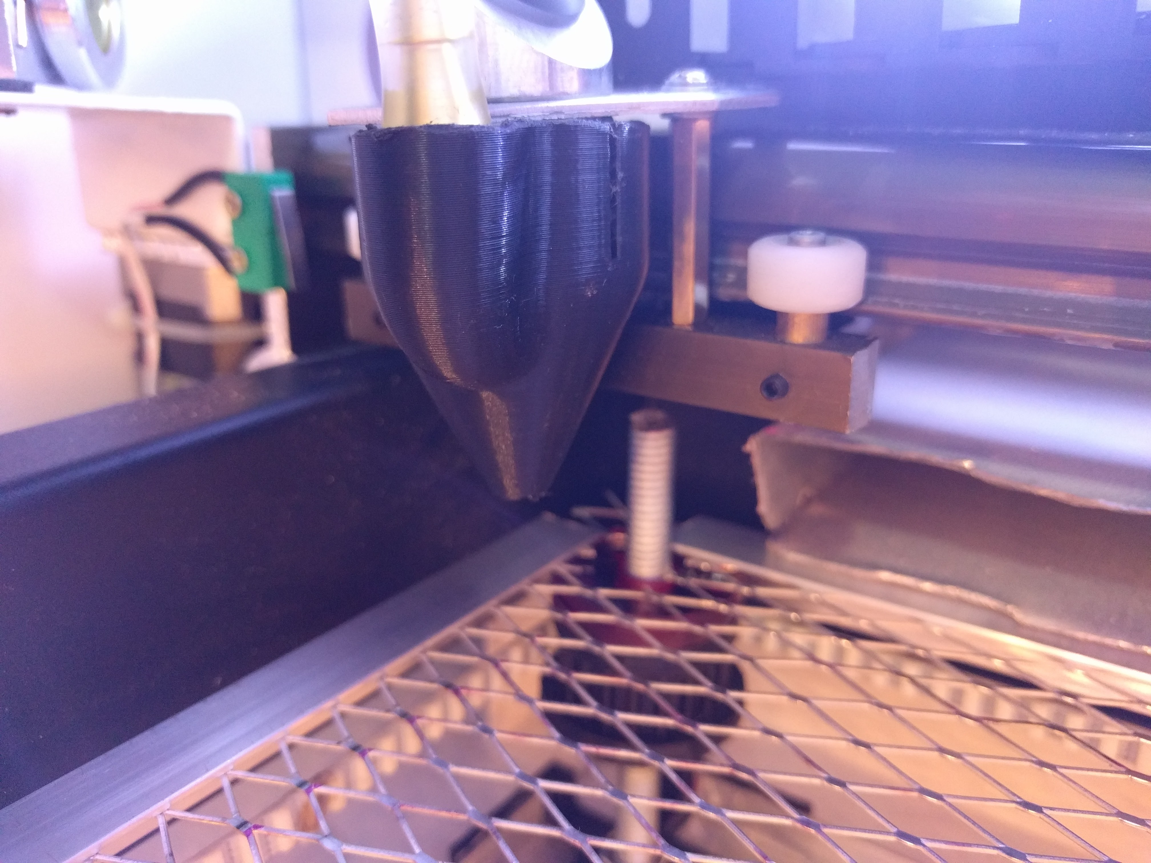

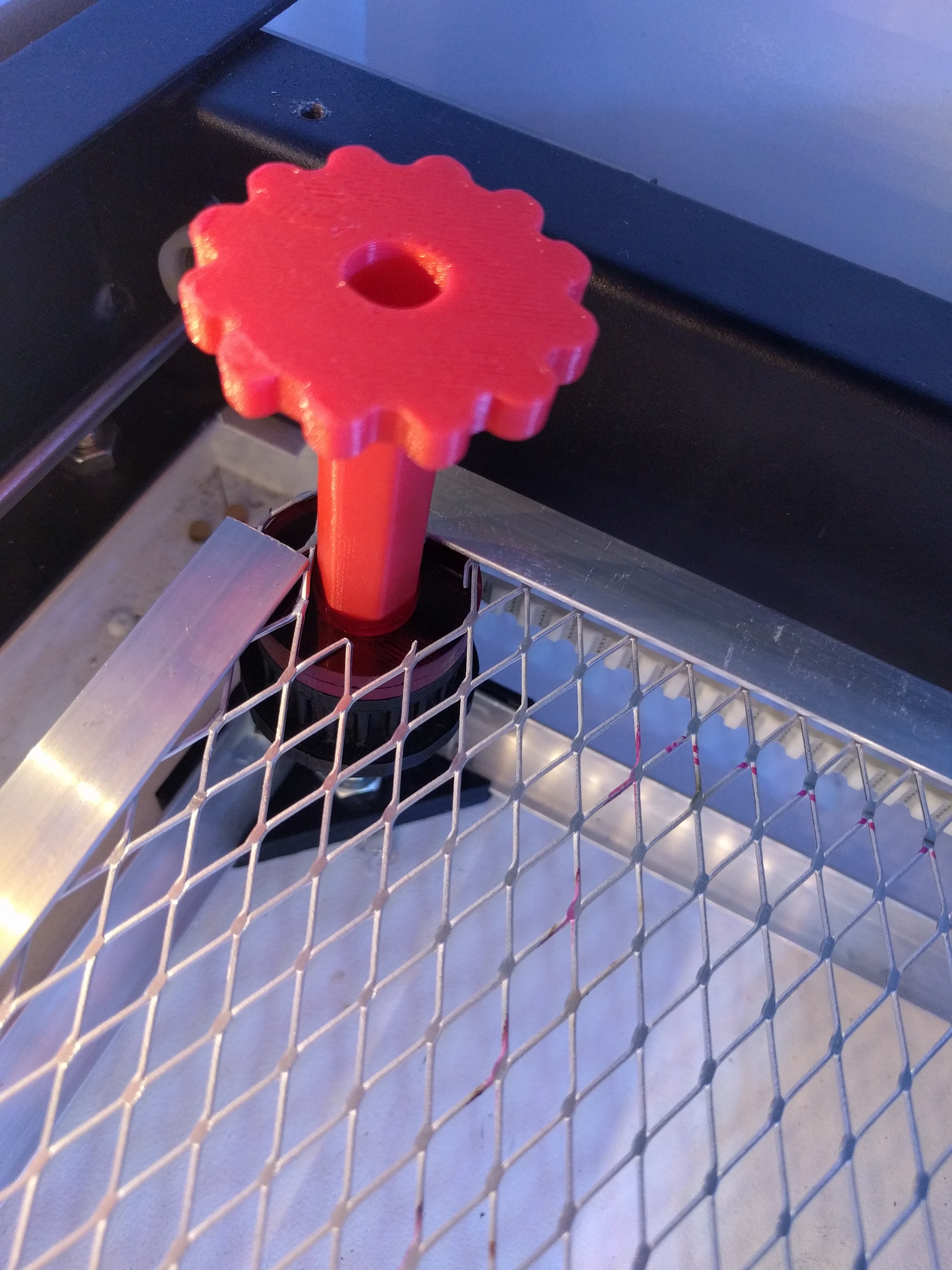

So I did some close observation and what was happening is the angle aluminum was putting pressure on the belt causing it to skip. So I cut out 8x spacers (2 for each corner) cut out to the diameter of the belt hubs and the inner holes cut to the diameter of the threaded rod for 6x of the spacers and 2x spacers at the diameter of the knob. All it all it works great. I put some Teflon lube on the threaded rod and this guy works nice and smoothly.
Sometimes its the simple stuff?
Don, you are correct there. The only issue I have is that I lost a few mm of work space inside the bed due to the threaded rod poking up. The difference isn’t much. The usable space went from 325mm x 225mm to 323mm x 220mm. I still have enough rod to try and cut them down by an inch or so but at this time i don’t think I need to try that out.
