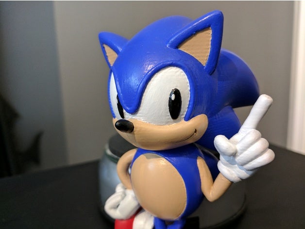

Made another Sonic figure.This one 200mm tall. Printed in PLA with 0.3mm layer.
Made another Sonic figure.This one 200mm tall. Printed in PLA with 0.3mm layer. 60mm / s printing speed and 0.5mm airbrush nozzle .6.5 hour printing time. Printed on my DIY printer.
@shauki
Printed this with 2 outlines and 1% infill.
I was wondering how you did it in such a short time, until I saw that it was only 1% Infill. I printed a goblet a christmas time that was 180mm tall using a .3 nozzle and .1 layer height, took 147 hours to print at 35% infill.
