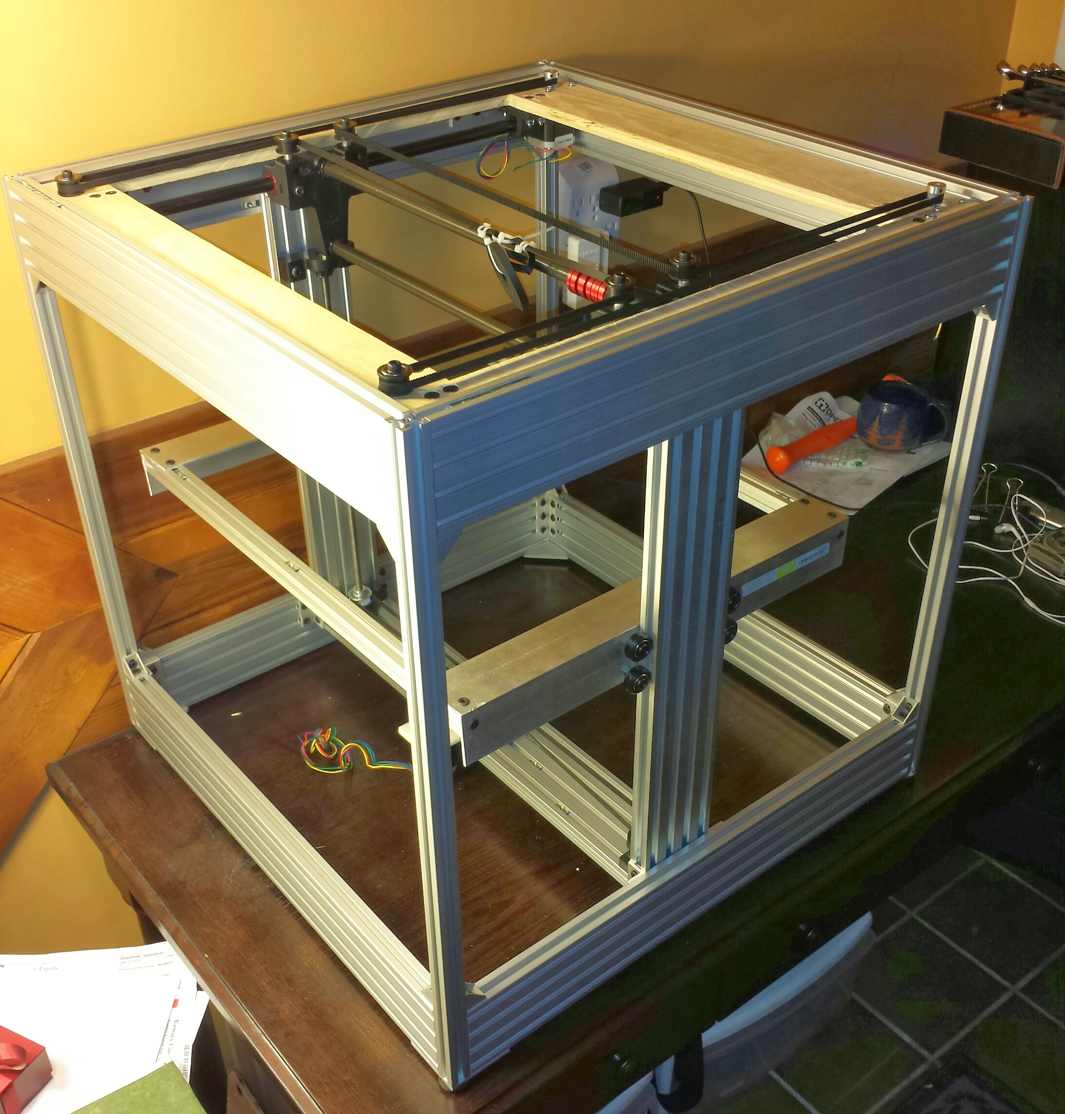

Made more progress this weekend. Bed carriage and z-stage is cobbled together.
Made more progress this weekend. Bed carriage and z-stage is cobbled together. It is not the final parts, but I had to use what I had laying around.
I made a temporary lead screw nut using a M8-1.0 nut, a rubber grommet, and super glue. it actually works really well and has the added benefit of allowing for misalignment.
So now that I am at this stage and my design seems to be working mechanically… I went and bought the expensive parts this weekend:
  1. 24v x 450 watt MeanWell power supply
  2. Azteeg X3 w/ Viki LCD
  3. 2 x EZstruder Mounts
    4.) 2 x E3D-v5 hot ends
    5.) Large 24V silicon mat bed heater
Once I get some miles on it I will replace the M8-1.0 threaded rods with a real leadscrew.
Mighty nice.
Nice built. I’ve exprienced some ocasional asymmetric motion when changing direction on the sides’ sliders of H-bot configuration. Did you notice anything like that?
That looks like one sturdy frame!
@Miguel_Sanchez not yet… But its my first printer ever and it has never been powered up. I will be getting the electronics by the end of the week.
That reminds me. Is anyone willing to help me setup a marlin configuration for this? I sure I can figure it out… But if someone could help me with the basic config it would be appreciated.
That’s a serious frame.
@Eclsnowman Actually, it is quite simple: similar to other 3D printers configuration but select COREXY in Configuration.h.
http://airtripper.com/1145/marlin-firmware-v1-basic-configuration-set-up-guide/
@Nathan_Ryan Thanks. Should be really easy to make an enclosure. Just add side panels. I need to figure out the top of the enclosure still. I will probably glue up some lexan panels to create a 5 sided box with hinges at the back so the electrical and filiment has headroom to move freely.
@Miguel_Sanchez thanks for the great link. I will work on this tonight. Can I hit you up if I run into questions?
@Eclsnowman Sure, but I’m in GMT+2, so I will go to bed in five hours
