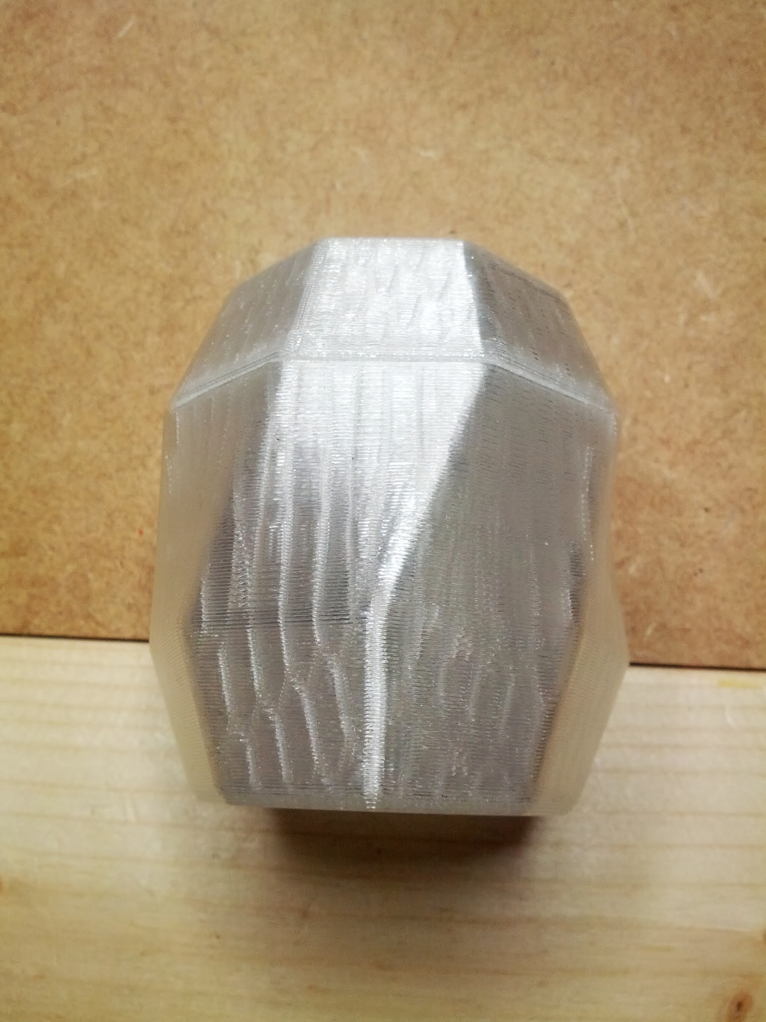

Made one in T-Glase from http://taulman3d.com   Amazing layer bonding and strength given the
Amazing layer bonding and strength given the layer height of 0.4mm!
Replicator 2, No cooling fan, 75mm/s, 235 degree C, 0.4mm layer height, cold bed on painter’s tape, no warping, print time about 1 hour
Running a 0,7 Nozzle?
Standard 0.4mm Makerbot Replicator 2 nozzle
