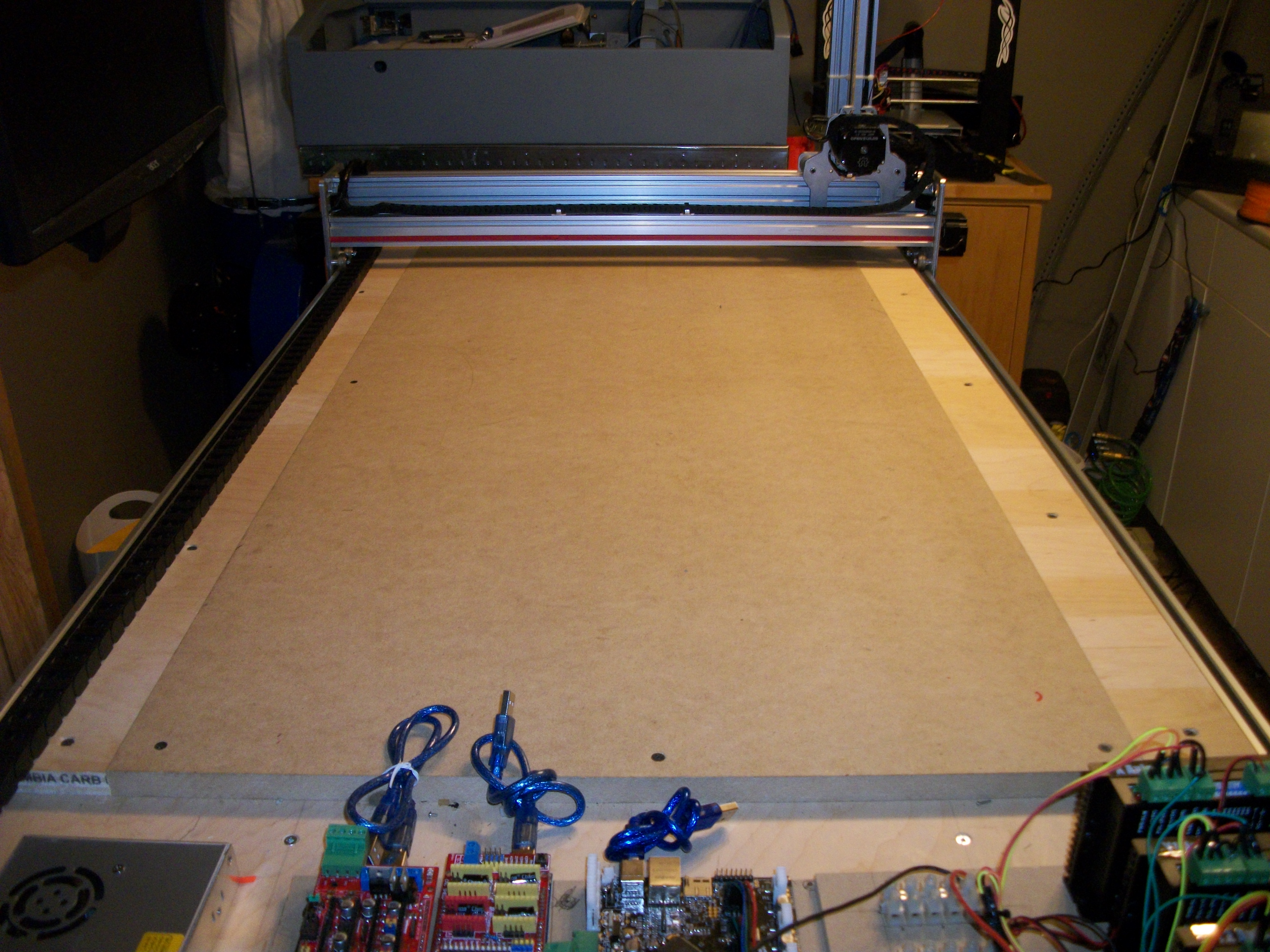

Made some real progress today on the test rig, managed to get all the cabling run in drag chains all nice and neat the way I like it. Tomorrow should be the day that it will make its first small moves to calibrate the steppers and drivers. Colour me excited!

you carrying the tube upright?
No, just a laser diode for laser testing and a 1.5kw spindle for cnc testing
