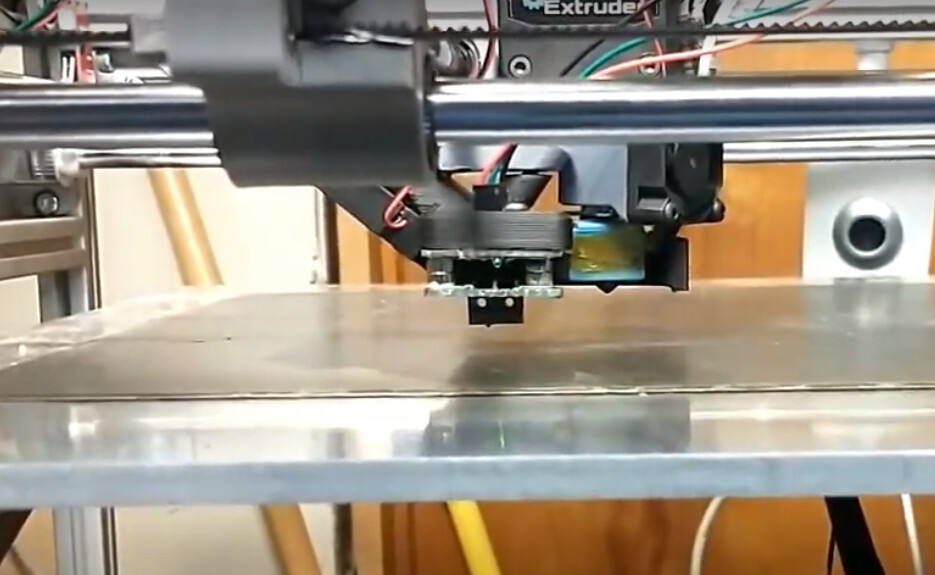

I came up with using 2 identical PCB’s and magnets to electrcially and mechaniclly coupole an Omron switch as a Z-probe BS’g with OchoCmino of CroXY fame.
Here is the board: GitHub - nionio6915/Euclid_Probe: Euclid probe, a magnetically coupled Z Probe Sled
Here is its deployed on the carraige. For a while I used it manually, and honesly, that worked out really well.

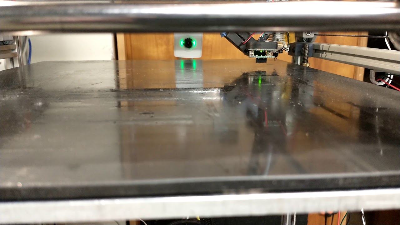

Here is a better video of the probe getting deployed from a fixed dock on the bed.
What a neat solution! <3
I really love the tool pickup, simple and effective.
