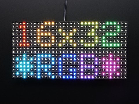

You could use p10 panels.
There fairly cheap on AliExpress.
Just make sure there’s a library that supports the scan rate you buy.
