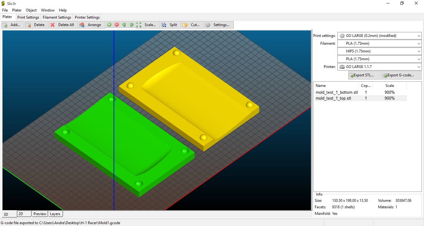

Making a small mold for an experiment. Planning on using expanded foam construction for a new project (will make a formal project announcement shortly). Picked up Fusion 360 as my main CAD tool for this project.

I’m still learning how to use Fusion 360. This is my first attempt at sharing a model so others can help experiment with mold making. I took this model and scaled it up to fit my build plate. Check out and download the mold model here: http://a360.co/1NOqYpS

@anthony_white2 , I picked up some Foam-it 3 and some wax mold release on the weekend to experiment with (Foam-it is a 2 part polyurethane foam). I started to print the mold, but I need to tune some of my slicer settings to get faster prints at this scale.
