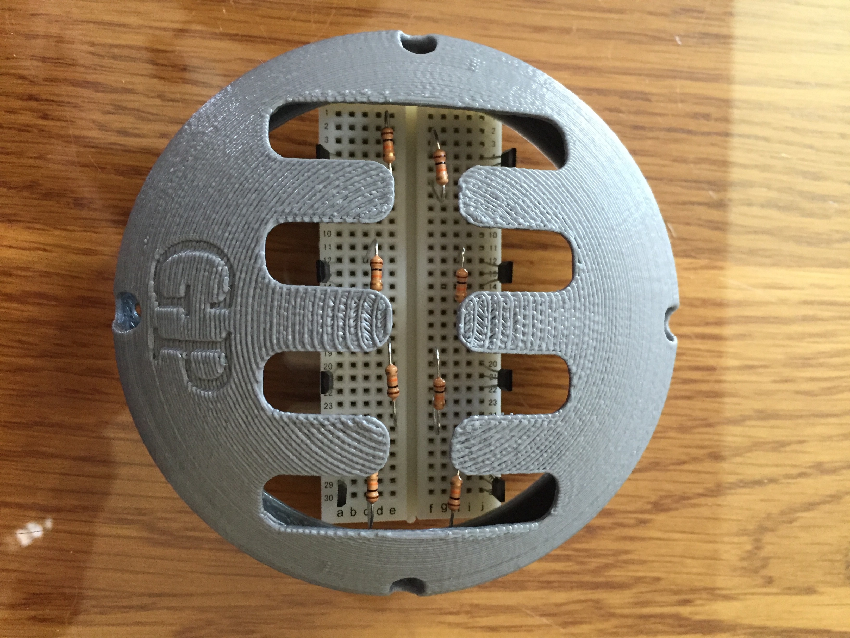

Making progress on the Open source 3d printed simulator shifter.
Making progress on the Open source 3d printed simulator shifter. Just got my A3144 Hall effect sensors in today with 10 for $1.59 shipped! I’m aiming for the whole build including the arduino Leonardo clone to be around $10-$12.

@Casey_Hoke yup. I once in a great while like to play racing simulators and love having a stickshift feel, but I am not super serious/involved so I can’t justify spending a lot on one. SO I decided to design a casing for it which you can see the first version of the top portion above, and am using hall effect sensors for 1-7 gears and a reverse. I will make a full in depth guide video once I get the first one working.
