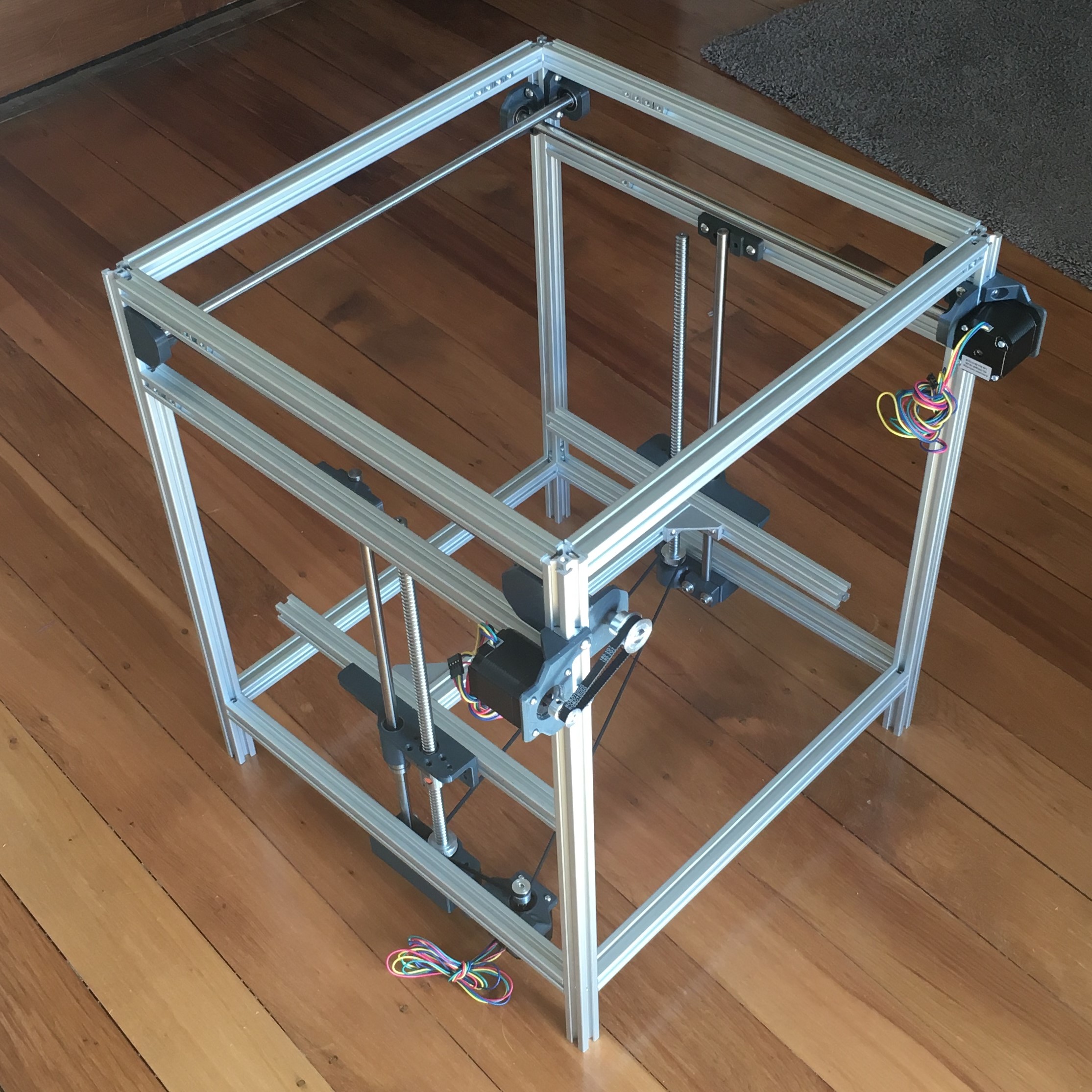

Making progress (this is just a test assembly to check things fit etc not the final build). Heated bed and bed plate the last big items to sort out. I got a mains silicon heater but have since started having second thoughts - 220V here, kids etc. So thinking I might revert to a 24 volt heater for the time being. How long is it likely to take to heat the bed to 60 Deg C? (PLA/PETG). I have a duet. Power supply is 24v, 10A. SSR still? Second power supply? etc. Recommended 24V silicon heater? Any advice much appreciated.

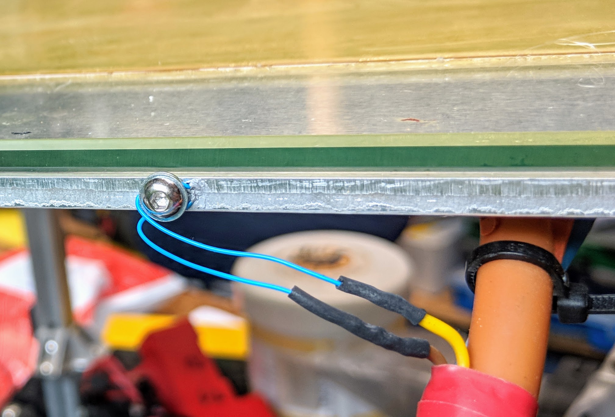

I jest but really a so long as you give the bed heat spreader a path to ground (so you limit any chance of charging an isolated conductive object) you will be just fine. Plus the current is much lower at 220V, so in my opinion it’s safer and able to hit higher wattage for high bed temps much easier.

I’m using an AliRubber silicon heater on another printer, too, and after about a year the silicon cracked open and the wires got exposed where they go into the main mat. It didn’t short to the frame, so had this been a mains power heater there would have been a very real chance of me touching it.
You’ll probably also be using tools with your printer (e.g. metal spatula to remove prints) and there’s always a small risk of accidentially ramming that into the cables/mat.
That’s why I’d really recommend staying away from mains powered heater.

Either way you should make sure that there’s an RCD ideally directly on the plug that powers the printer or nearby on the line.
I’ve also embedded a thermistor into the aluminium bed to get a more accurate reading and can recommend that. Same way as the old E3D thermistors were embedded into the heater blocks with an M3 screw.
