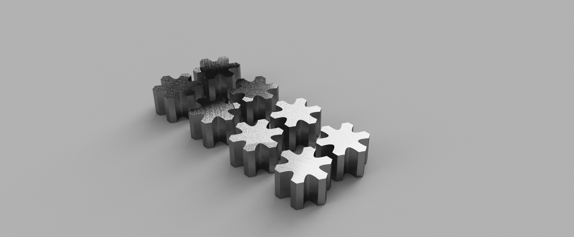

Making some aluminum for a project. It turned out well the second time around.
Making some aluminum for a project. It turned out well the second time around. The first time I tried moving too fast. The second was much better. Could have made the tabs smaller.
Curious to see what speed feed and rpm you used?
The first attempt failed at .24" depth. I was running 51in/min with 0.02 step over 0.015" step down. It failed on adaptive clearing. The second attempt was ran at 33 in/min. Then the contour/profile was ran at 10in/min.
Great looking cuts!
