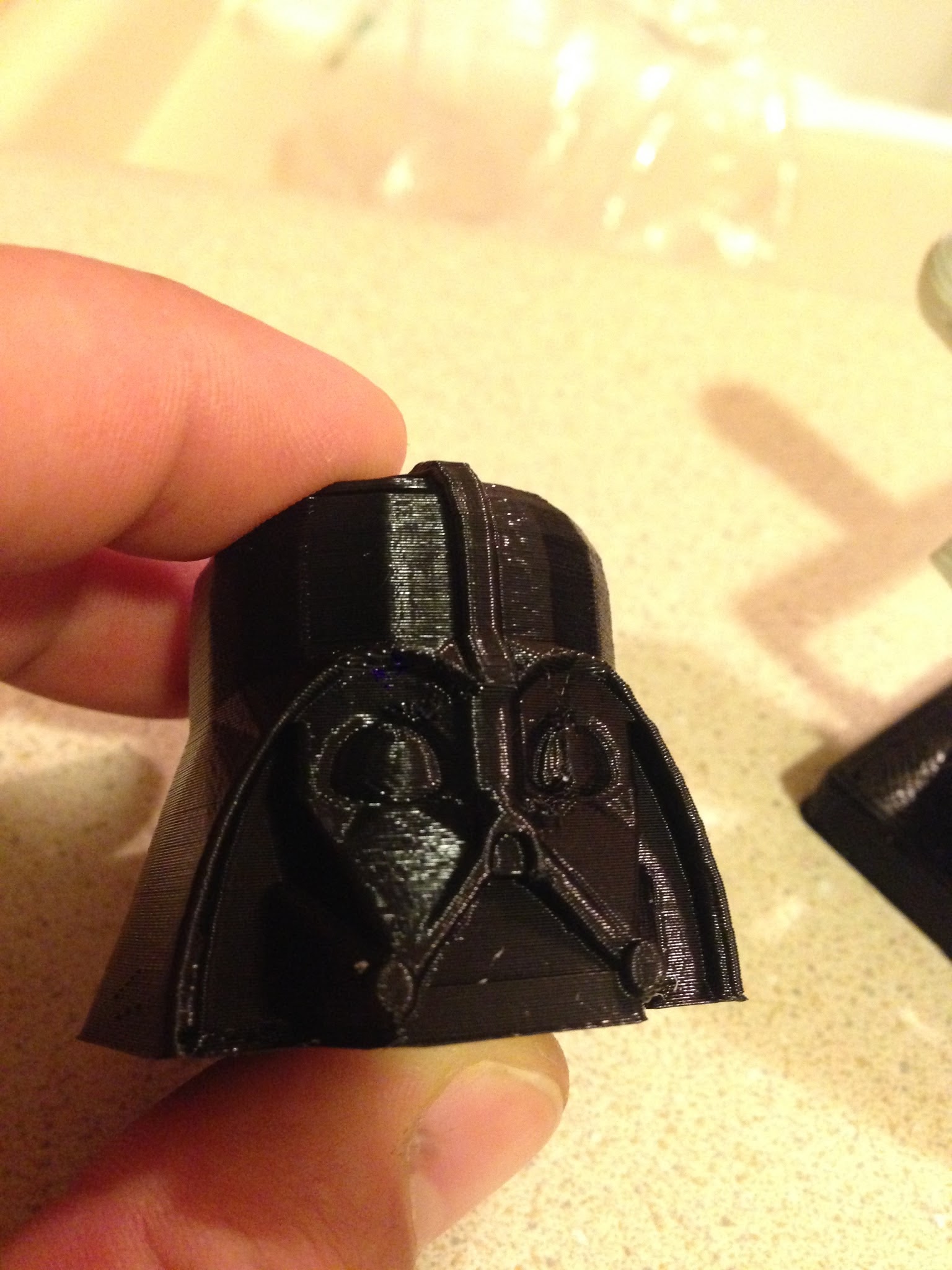

Making some new doorknobs in preparation. May the force be with you.
.8mm nozzle with .2 layer height
Can you share the file please?
@Jason_Mitchell http://www.thingiverse.com/thing:164596 Happy printing
.8mm nozzle with .2mm layer height?? That kinda interesting. Never heard of such thin layers with a wide nozzle like that. Print looks really nice!!!
Thank you
@Griffin_Paquette What I’m finding with the larger nozzle and smaller layer height is the layers become less defined and much stronger. you loose a touch in the edges, that small crease in between each layer becomes smaller.
