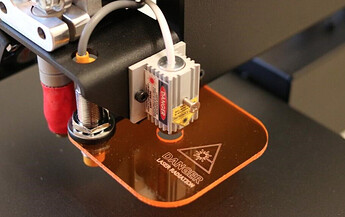

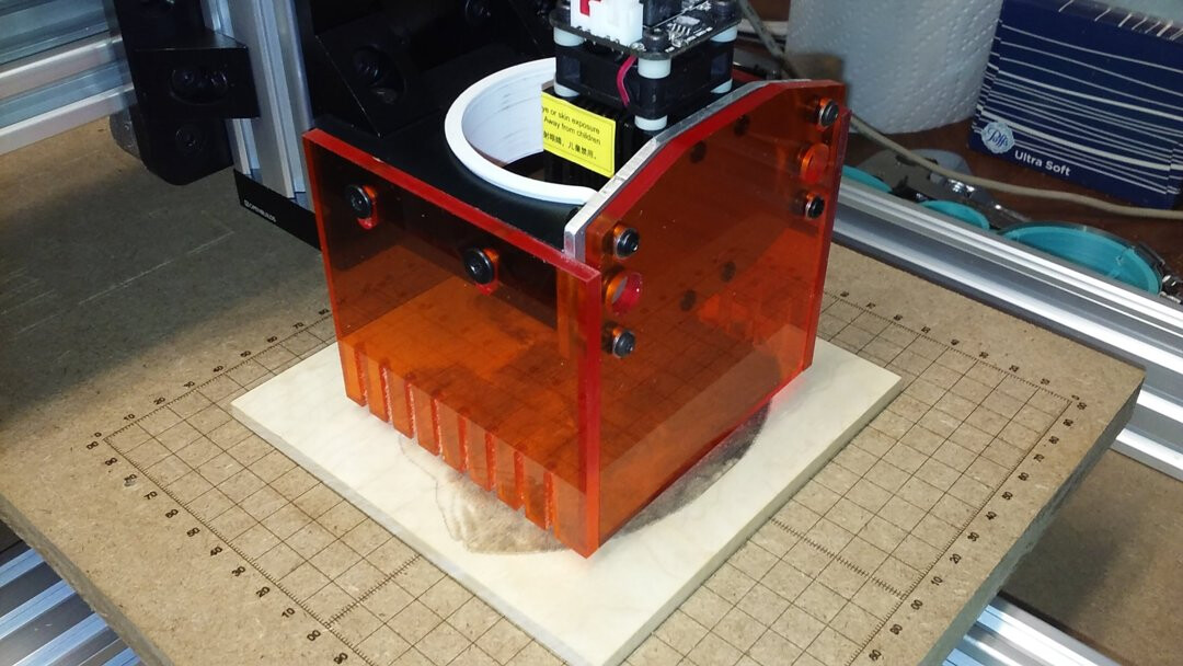

Laser Sheild
Here is a simple method some use to shield the laser module on CNC units. I cannot see any glaring practical flaws using this on a portable machine if it is combined with the interlocks above. Do you see any use cases where this could be unsafe??

  • I plan on an enclosed cabinet with an evacuation port that connects to a fume filter box that is about the size of a small vacuum cleaner.
The thing I don’t like about the side sheld/box approach is how it traps the smoke in the lens chamber. Even with an air assist nozzle blowing sideways in there it’s not going to blow the smoke outside the chamber.
The only solution to this I can think of is a double walled side shield/box where a vacuum was pulled on the space between the 2 walls so the smoke was pulled out and most air was pulled down through the fins of the heatsink around the laser. Hey, you could probably remove the fan on top in this case if there was sufficient radiant heatflow for anything getting hot on the pcb driver board up there.

I’m going with the type where there is a shield on one plane above the lens. I think when combined with side frames it will be safe.
