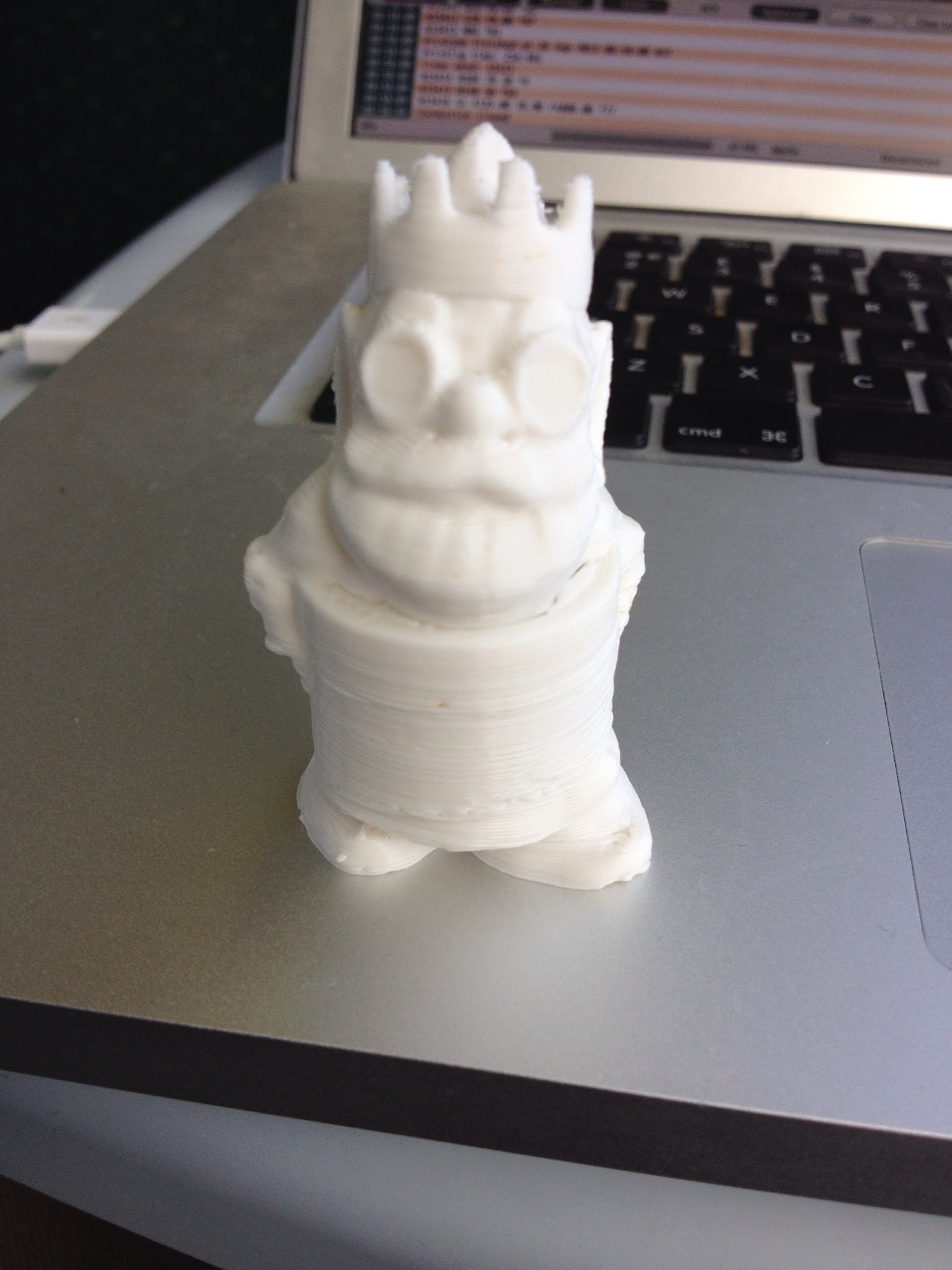

Managed to do another gnome test print last night at the normal size.
The results seem better but the nozzle still seems to be over extruding in parts.
I’ll have to tweak the settings a bit when I get back from work tonight.

@ThantiK printing it full sized and slowing the print down helped.
I’ll tweak the e steps next :slight_smile:
