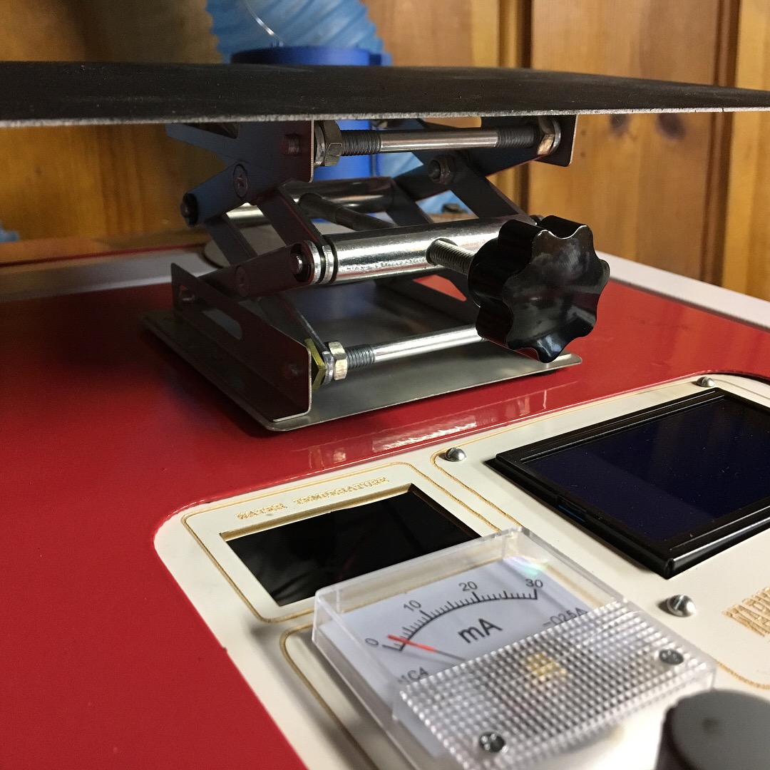

Manual Z Axis. Available on Amazon for $17.99. Search for Lab Jack. Super useful.

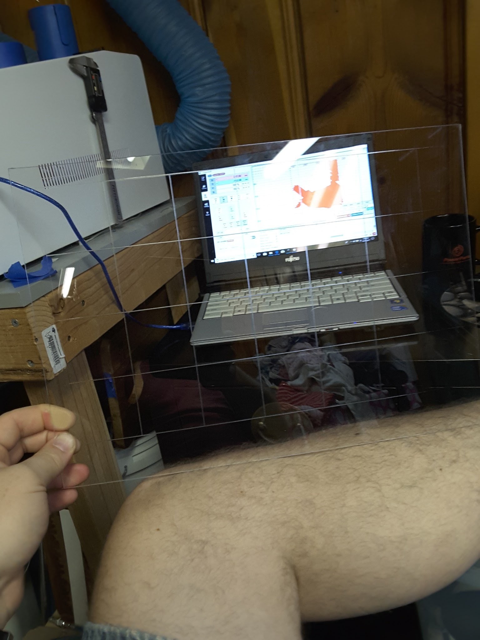

It’s not without its flaws. I made this acrylic reference grid that indexes with the gantry to line things up if necessary.

This is what Ive been using for maybe a year or so now. its perfect. I started with a larger one but found it didnt go down as far as I wanted, plus it was tough to reach the adjustor knob while in the laser. So I got a smaller one and its perfect.
Yes, some of the larger ones are 3" closed which is practically where the focus height is.
