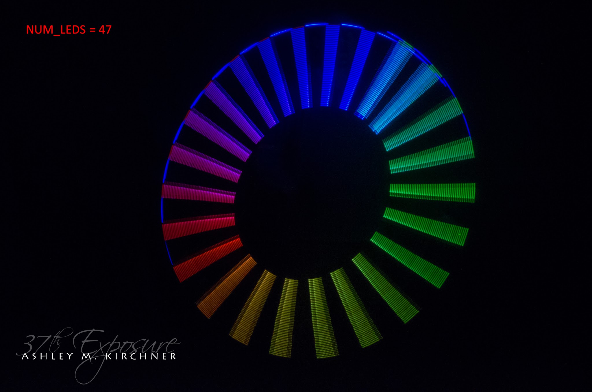

@Mark_Kriegsman and @Daniel_Garcia , you guys hit the nail on the head! This is with 2.1-Dither. Using 2.0 this does not happen. Remember the actual length is 48. Count the dots. :slight_smile:
What I don’t understand is, why is that trailing (blue) LED only happening on a portion of the wheel. It goes away once the hue hits green to red then it reappears.
What is your rgb ordering?
RGB … being custom made strips, I made sure they’re wired correctly.
How easily can you try out using the hardware SPI? I’ve been taken down by a migraine (tis the season?) - but i’m suspecting that this is being caused by something with the bitbanging - i’ve had problems in the past with things getting shifted because the last led chip didn’t latch properly (which is why, for a while, the library was sending out one extra pixel’s worth of data for SPI chipsets)

No, I just want to verify whether the problem exists across the board w/SPI or if it’s just bitbang’d SPI - you can probably get away with writing out 49 pixels in a pinch w/bitbang’d spi if i can’t get it fixed.
