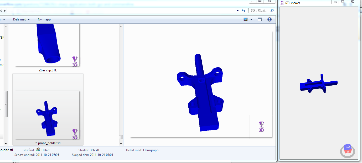

Marlin3DprinterTool has STL viewer and STL thumbnail Shell Extension to Windows File Explorer.
Picture shows Windows File Explorer with both STL thumbnail as icon and preview.
The Right Window contains the STL viewer with zoom/pan/rotate/resize

There must be some steps I am missing. Everything except the preview works.
@Mark_Tomlinson same for me, unfortunately. Installed, cleared thumbnails, rebooted, but still only the default program icon for the stl viewer. I’ve had stl previews working a few years back, i think it was the extension from one of the Autodesk tools, but i’ve been dearly missing the functionality ever since.
Win10Pro, x64.

@Mark_Tomlinson @Thomas_Sanladerer Give me more info…
Do the STLviewer work?
It should be a shortcut and are possible to drag-and-drop files into. The STL viewer is the same code that creates the thumbnails but with a GUI attached. Actually it was my “debug” tool during development.

The only part in Windows that looks like it is case sensitive is the Shell Extension in Windows File Explorer. Works with .stl but NOT with .STL.

On windows 10 the “unknown application” is shown if the stl extension is not assigned to a application. If I assign STL to Simplyfy3D it shows S3Ds icon in the thumbnail aswell (= right behavior)
Only getting this, independently of .stl or .STL extension. The viewer works flawlessly!

To me it looks more like the shell extension didn’t register correctly. Anything i explicitly need to do for that?

I have uploaded a new msi and a stl viewer and stl thumbnail debug guide

@Johnny_Linden the dll did not install nor register by default, following the steps in the debug guide sorted that out and i’ve now got working stl previews, even when the stl viewer is not the default program for them.

The STL thumbnail do not need the STL viewer as default STL viewer. If you choose Simplify3D as prefered STL viewer the icon on the STL thumbnail will change to S3D icon. Its made so by design.
The colors of the STL viewer and thumbnail is able to be configurable… The hardcoded colors used are faster than a configurated value.
