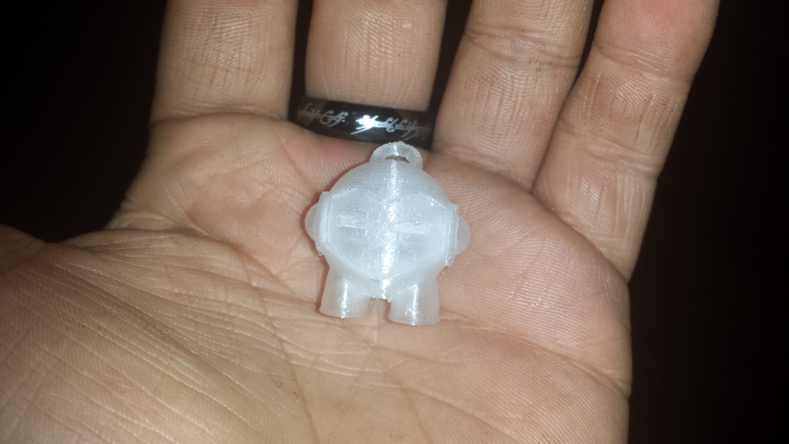

Marvin 150um layer height PCTG printed using default PET settings
You’re under-extruding. Also, shiny. PS. What caught my eye was the ring you got :slight_smile:
Really? Im underextruding? How can you tell? And thanx lol. I have quiet a few rings. I wear them all in the same finger thou lol. But one at a time ofcourse
Well, I’ll admit that I don’t actually know if you’re under-extruding. It looks like it to me, just a tiny bit, but I dunno. Maybe try increasing extrusion by 0.5 and see? Printing Marvin doesn’t take long :slight_smile:
Yeah ill try that. I really dont know how to tell either lol. Im still new to all this. The temperature for printing this stuff thou. HOT! ima start printing with this in the winter. I wont even need a heater lol
Eh not really underextruding. Maybe a little bit, but clear filaments magnify issues imo
I feel like its just the texture of the filament. Because i really dont see anything wrong with it :confused:
@Cristian_Martinez Maybe it’s just as @Griffin_Paquette said and clear filament just throws me off. I should probably get me some, too, to play with.
Yeah i got 50g of PCTG as a sample to play with. I was a littl unsure at first as the first few layers didnt want to stick
