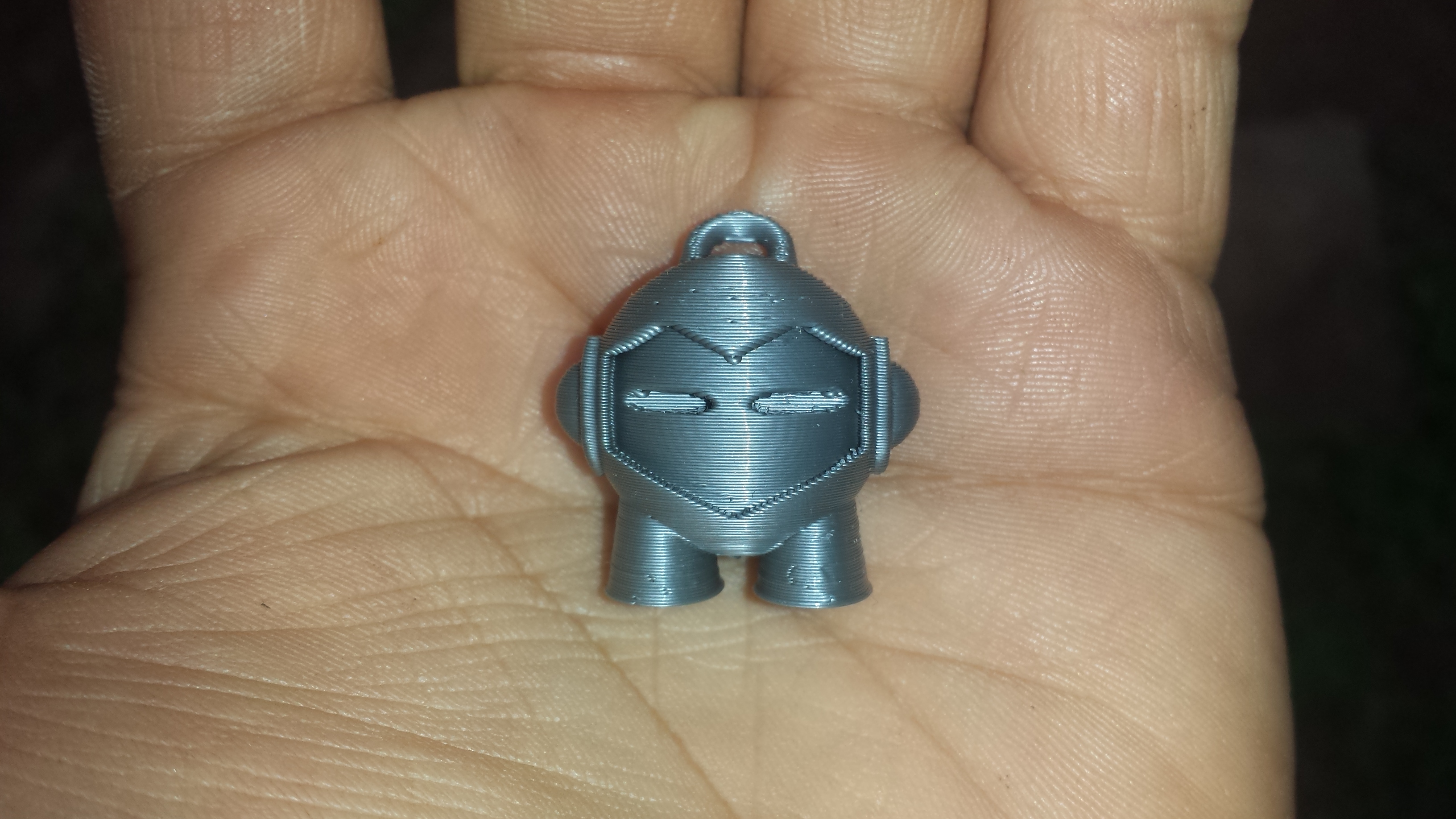

Marvin at 200um layer height.
Marvin at 200um layer height. How does the quality look?
So tell us more about the printer you used …
That first layer is nice and squished, was it hard to remove from bed?
I use a PrintinZ skin and sometimes my prints are really stuck on the bed, there is only so much force I want to put onto a razor blade with my fingers…
@Roland_Barenbrug ​ its a Prusa i3 MK2S @PrintinAddiction ​ it was a little hard but not too bad. I only have to use a razor on big prints the smaller ones arent too bad
Really impressive print! It could be even better if you would tune the start/end of the extrusions. You see the small underextrusions? Those are usually called the “seam”. You can improve them by tuning the extrusion settings.
How so?
