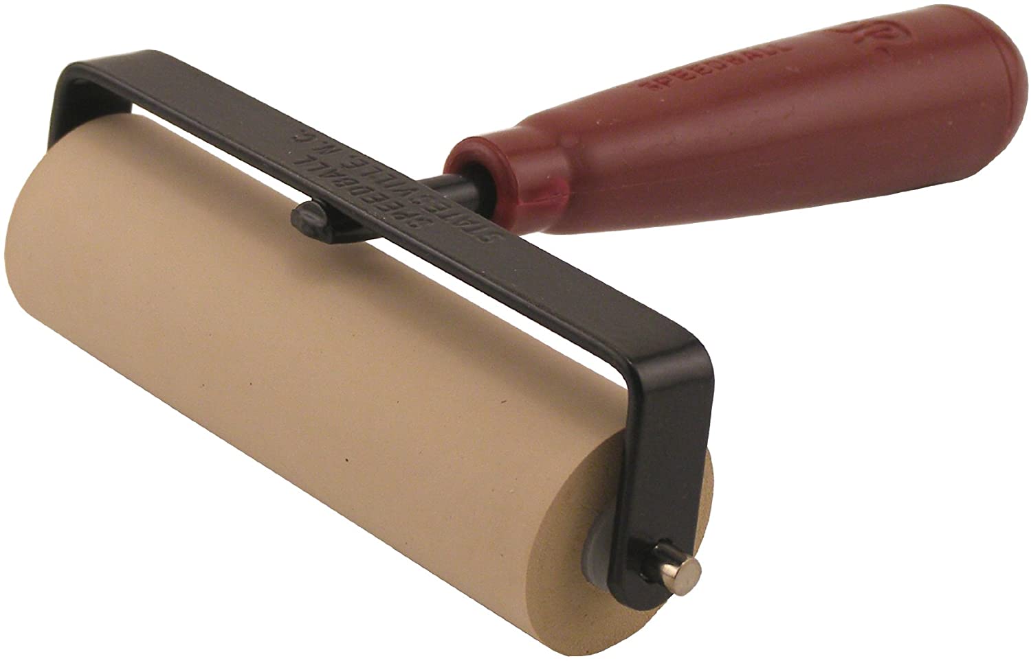

When using transfer tape it’s also advisable to get a (4-6") ink brayer roller like the one below. Makes getting a smooth lay down of the tape much easier and also allows to make sure it’s sealed down tight.
