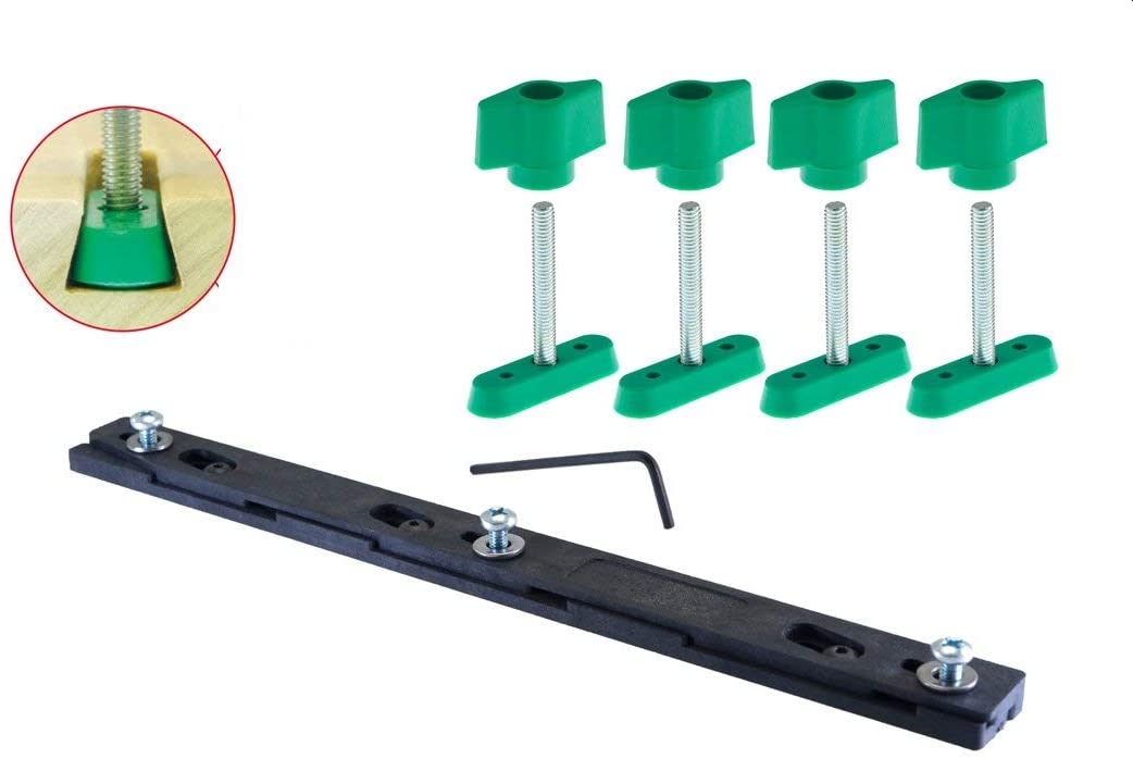

Following the instructions that came with the sled kit, it was straightforward to build. The miter bar was a dream to install and adjust resulting in a perfect fit. If every you need a miter bar its worth it to just get this guy:
It adjusts in the track before you install it on the sled… way easy.
